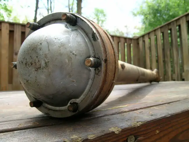

I recently bought a 2000 Ford Explorer 4.0L SOHC 4x4 4 door and didn't crawl under it until after I bought it. I know what a rookie mistake but its really the first vehicle I've bought that wasn't out of necessity.
So i have no front driveshaft and have been looking around for the right one. The front axle has a standard yoke for a u-joint but the transfer case end has just a flat round plate. After looking at the images on several different site I can't imagine how that driveshaft is going to fit a flat plate because its round. Any help would be appreciated.

You need one that looks like this?
But you have this type?
The top picture is what I believe I would need. It has six holes that are threaded. I cannot find this driveshaft on a website when searching for a 2000.
The bottom picture seems to be the most common especially in part searching. This cannot fit my transfer case flat round plate because of the bulge.

Check the part on your transfer case: it likely has a concaved hollow into which the "bulge" shown on the C-V joint fits. This is held in place by six long metric bolts, I believe they are 8mm diameter......imp
(The other U-joint shown is a "Double-Cardan" Constant Velocity Joint, which I have not seen used on Explorers '96 and up, earlier I am not sure.)

Ok so I checked out my t-case and found the concave cavity for the CV driveshaft to go in. Thanks a lot on that. Went to oreillys and got a remaned driveshaft and strap kit. The only problem now is oreilly doesn't have the six bolts to attach the driveshaft to the t-case.
