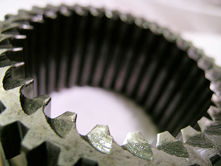

Ok... Transfer case is out on my truck.. heres the symptoms
1. no gears are engaging (not even park)
2. when i try to shift into gears my t-case makes a loud grinding noise
My truck has the automatic 4wd switch with the AUTO TO 4HI TO 4 LOW.
What I was told is that this switch sometimes becomes faulty and gets the shift motor locked in between 2wd and 4wd thus not letting the fork, inside the t-case, fully actuate all the way down with the gears, causing the gears to slip and grind
Does this sound right and has anyone else had this problem with the switch?
Is there a way to fix the switch or deactivate it? [/SIZE]
Any input is welcome Thank you very much in advance
