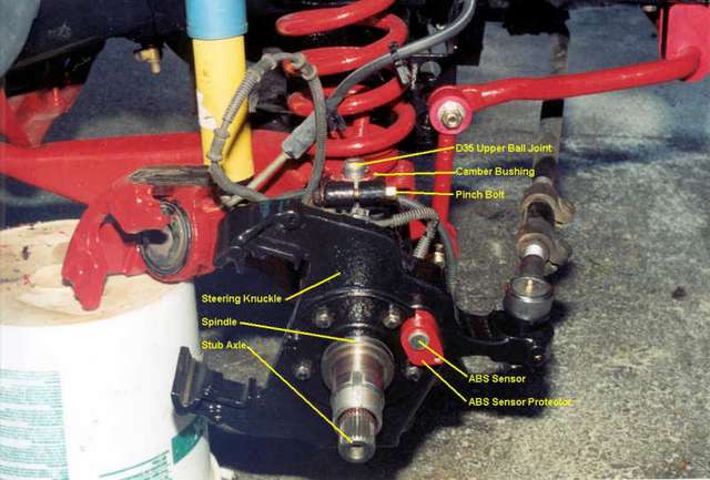

Are you sure the spindle is loose? The axle shaft passes loosely through the spindle as shown below.. It may appear the axle is loose because the HUB is removed. When the hub is installed the axle splines are supported by the hub and there is NO looseness. Anyway the spindle bearings have ZERO to do with anything since the front axle only rotates when in 4x4.. If your not in 4x4 the axle is static.
