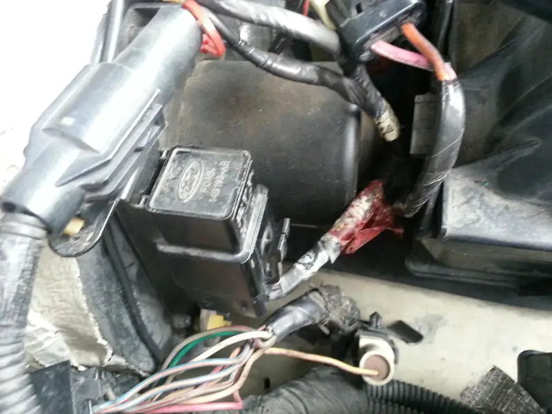

Went out this morning to check out my truck. Checked the connections at the blower motor and the resistor and they both had no power. Went back and checked all the fuses the 30A under the dash in slot 12 and the 50A the Power Distribution Box slot F-3 under the hood. Both were good. Referenced my Haynes manual to see if there was a relay for the blower motor. Discover there was. Had to trace the pink wire with a white strip to make sure I had the correct relay. It was mounted to the blower motor assembly. I took relay off the wiring harness and found it was corroded tried to clean it but no luck. Just to make sure that I found the problem I used a jumper wire to see if the fan would run and it did. Auto Zone is ordering the relay and should be here this afternoon. I will let you know if it works out.

It works Great!!!!! No more riding in the cold. I hope this helps someone.
