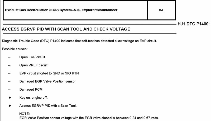

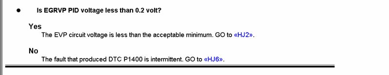

I looked up the description for P1400. It is a problem with the EVP sensor which feeds back the EGR valve position to the PCM. The code indicates a problem with the sensor or with the wiring between the sensor and the PCM.
