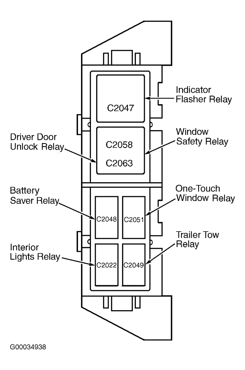

One of the following may be the driver's footwell relay locations for a '99. If it is either of these, please let me know so I can add that info to the file name to ID it again later.
View attachment 427363View attachment 427364

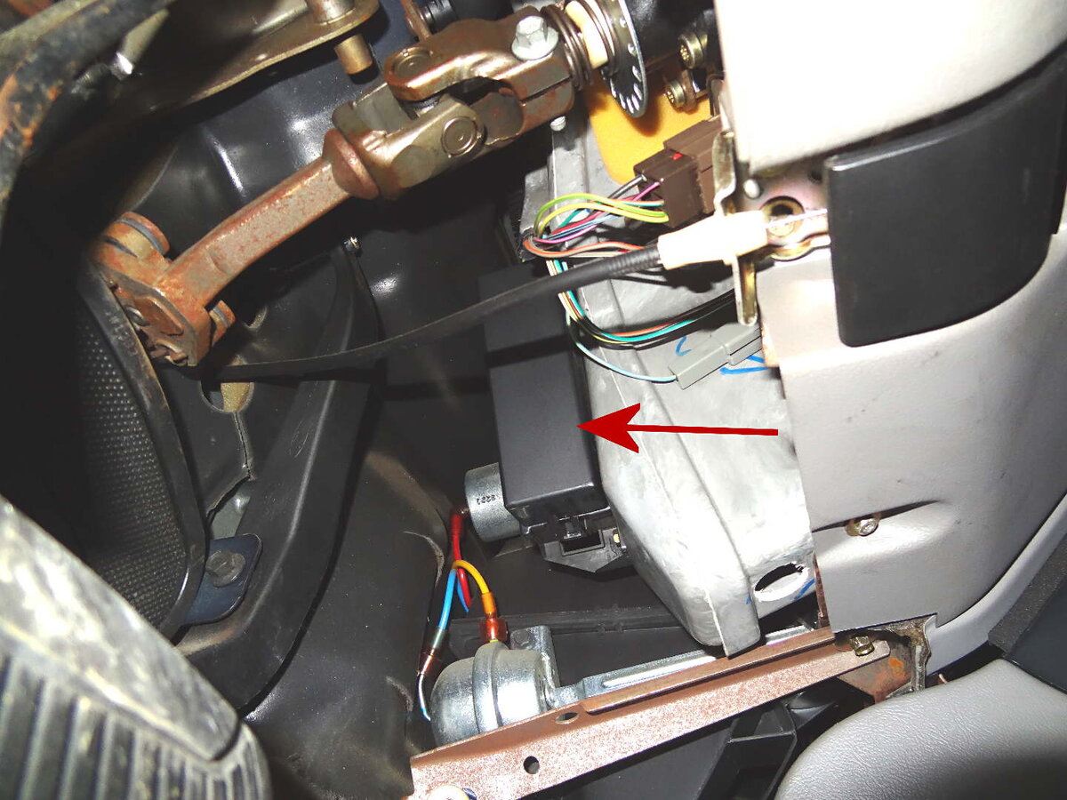

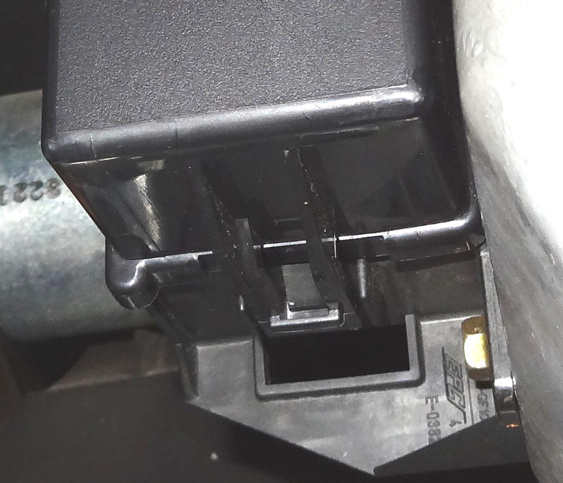

Here it is on my '98. For perspective, in the bottom left corner is the brake pedal. Hood release is in the top right corner. Arrow points to the black relay box. There's a springy plastic tab latch on the bottom, "maybe" one on the top as well.
It's accessed from the footwell, not behind the radio or cluster. Yes you need to be a contortionist, thanks Ford! I don't know if anything changed between '98 XLT and '99 EB.

THANK YOU THANK YOU!!!!
That's what I'll get to. I'll just pull seat out again to get in there.

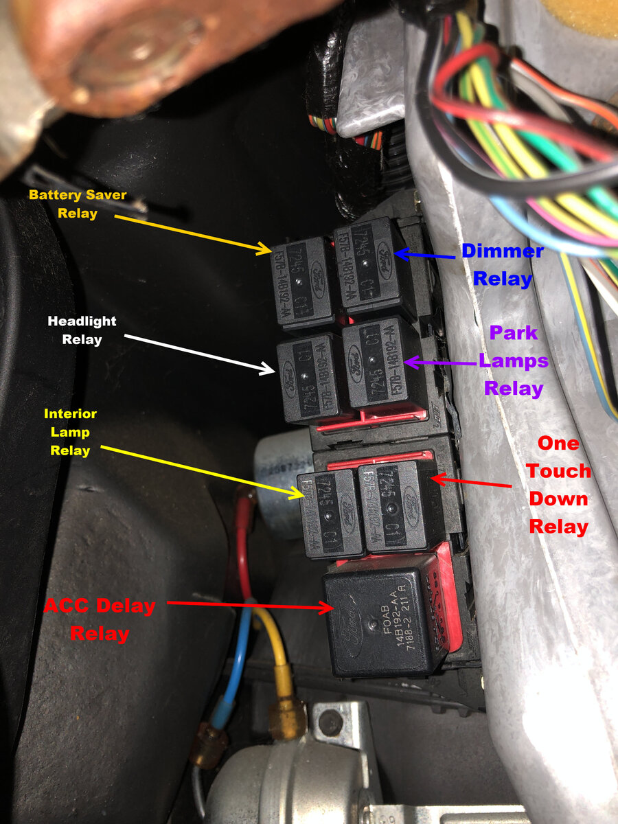

View attachment 428020View attachment 428021
