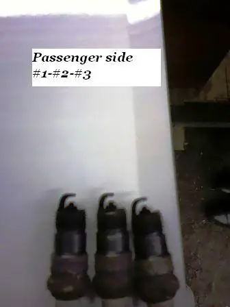

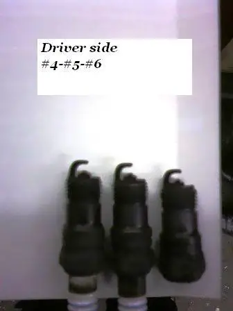

Hey Corkey. No the check engine light wasn't on.All the relays & the fuel pump kick on. I changed the plugs & wires this morning(what a chore it was doing the pass. side).Check Engine light came on after I changed plugs & wires. So i reset the computer. The light went out but it is still idleing kinda rough. The soot is gone after i ran it down the road abit.The longer it ran the better it started to get ,so maybe I'll drive it for awhile & see if it gets better with time.I'm gonna post pic's of the plugs. The guy I bought my little green monster from said he had it serviced it regularly. So either he lied to me or is service garage lied to him cuz there is hardly any electrode left.
Sorry they are blurry I used my camera phone & i don't have a steady hand.

well the plugs are a bit rough, ,
it gets better, might be just burning all the crap out of the engine and exhaust ,
i had this issue with mine when i bought it too, i changed the plugs and wires and the same thing happened, it got better and better,, that was about 170,000 kilometers ago,
