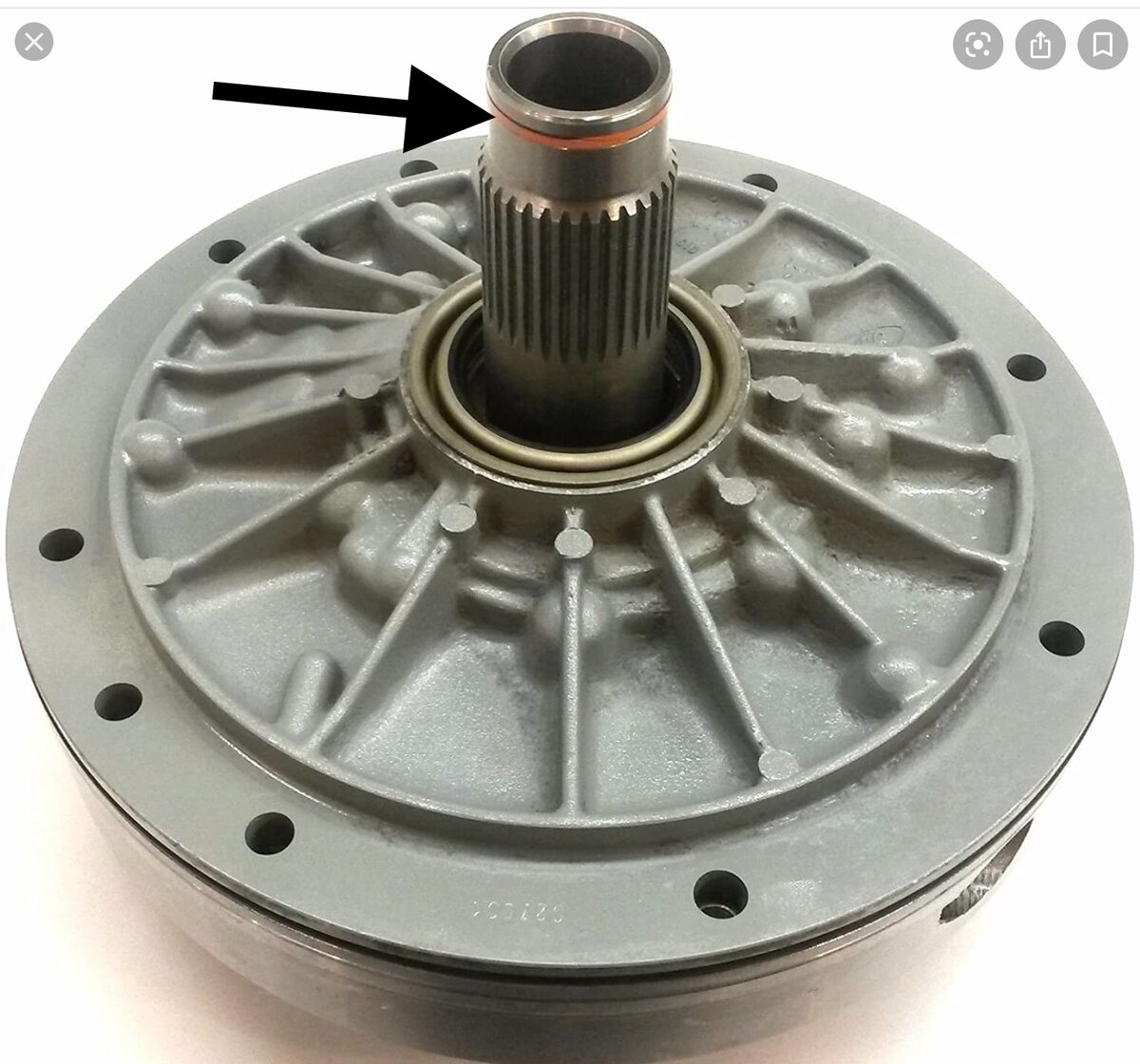

Likely a missed ground strap or connector that didn’t fully get seated. Was unit used or rebuilt? Did you notice if the sealing ring was installed or maybe damaged?

What exactly is your Pic showing ? Is that the Post/ Stem ( I'm sure that's not the Technical Name for it) coming out of Transmission from Bell Housing ?

Have you contacted the remanufactures for their support? When having that many connections disconnected while motor/transmission replacement some ground straps may have not gotten bolted back or on poor surface. Lot of times wires or harness will get crushed or cut also. The sealing ring I’m referencing will not cause a noise. Fluid in the converter is correct and not an issue. How are you retrieving the code? OEM software scanner or code reader? I would suggest to do some more diagnostics before pulling unit back out.
