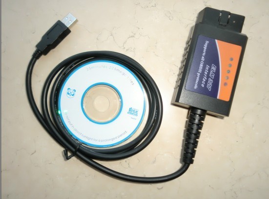

Hey!
This is the scanner i have:
Tried several softwares but none works. Tried on other cars and works fine.
I guess the problem is that this adapter has compatibility issues with ford protocols. Any sugestions on a good adapter i can buy from ebay? Or any other place that ships to Brazil. Thanks for the answers!

Before you go there (ie. buy another thing), I would make sure that your connector has the right conditions on all the pins.... especially since you say the thing works on other vehicles that you have tried.
When you say it doesn't work, what does it complain about exactly.

That is the model that had issues with Ford. Use the updated one like the one that I posted above (they have an USB version too).
Or if you really want absolute accuracy, go with the one that is recommended by many software products: Kiwi.
It is in Bluetooth or WiFi connections... no USB.

I have that exact same scanner, got it on ebay some time ago.
It works great with the Palmerperformance software on every car I have used it on.

I can confirm that that interface has problems with fords, that is the same one i have and it will work with anything but a ford
Bob, does the palmer performace software you speak of offer a free trial, cause i would like to see if a better software fixes mine, i have tried just about all of them that offer some type of trial and none of them will recognize my ford, but they all work with my 95 dodge

Thanks for the report. But i think I'll try buyng some different adapters, this software you tell me costs near $100 and i couldn't find any trial versions.
As soon as i have a new adapter i'll keep you guys posted, but it can take some time since i bough from ebay and it can take a month to arrive here in brazil.
