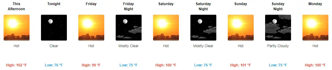

My weather:

We do have hot weather into the 80s & 90s and humid frequently in the summer but nothing like what you have. A/C in the winter I just open the window.
