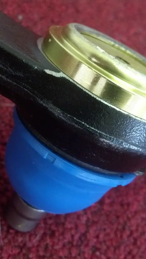

The bad UBJs; well not really. They were still tight but the boots were shot.
The Upgrade:
Didn't take a picture of the LH UCA, sorry. You can see the difference in ball joints, though.

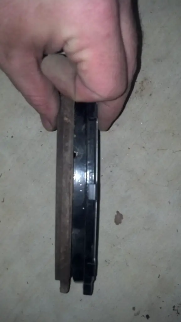

My rotors were still good and could have just been turned, but I went with all new Advanced Technology stuff and wanted to stick with it on the rotors for the full effect. Apparently missed taking a picture of the rotors, too. They're nice and shiny if you care. With a fluid flush and these new rotors and pads, I have no concerns about my ability to stop. I never had any issues before changing them but I was not confident and never had to try them. The pictures:

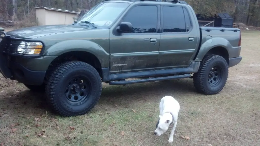

And finally, the Treadwrights. I won't make a premature review but I'll point out a few things I noticed immediately. Load Range E is stiff as expected but not as heavy as I expected. These are louder than the KM2s. I thought the tighter pattern would be more quiet but, oh, not so. Final observation, I've got some more trimming to do.:sawzall::D

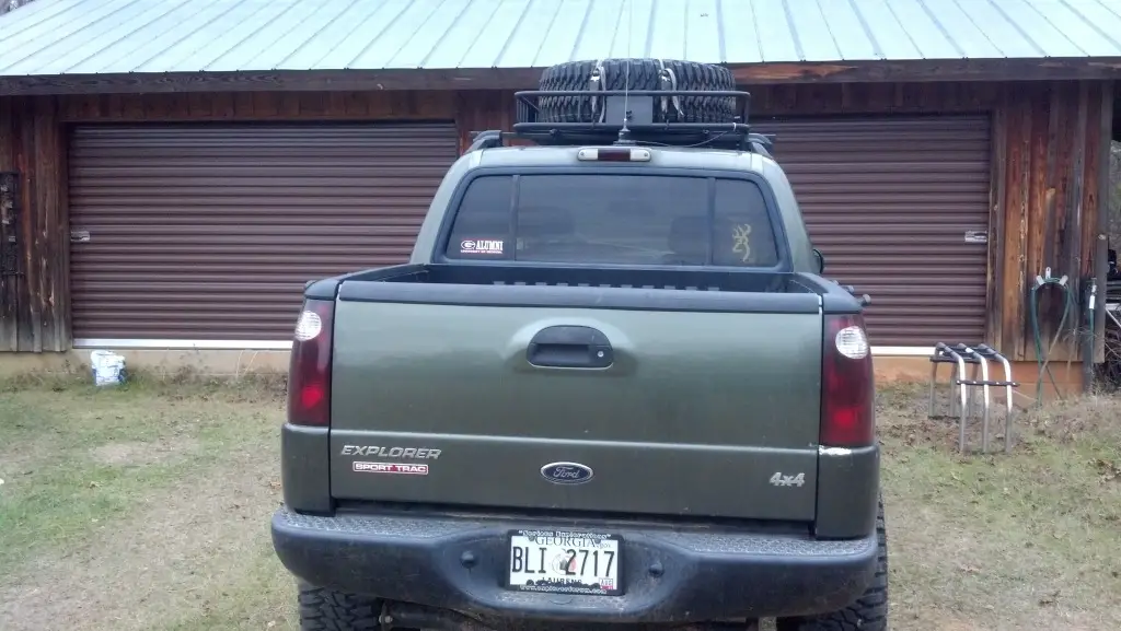

Forgot to post the first thing I did in this wave of updates. VHT Niteshades on taillights and third brake light. Three light coats on the tails, two on the third brake light. Not sure why the third brake light looks so dark in the picture.
Looks good Hugh. I'm not exactly a fun of darkening any lights (mainly for safety reasons) but it looks like you put just enough on there for looks but didn't overdue it. I like it.
What's up with the rachet straps holding the spare on the rack? I thought you got a spare tire old down from a junkyard car truck like I did when I had mine mounted up there.
