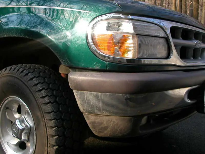

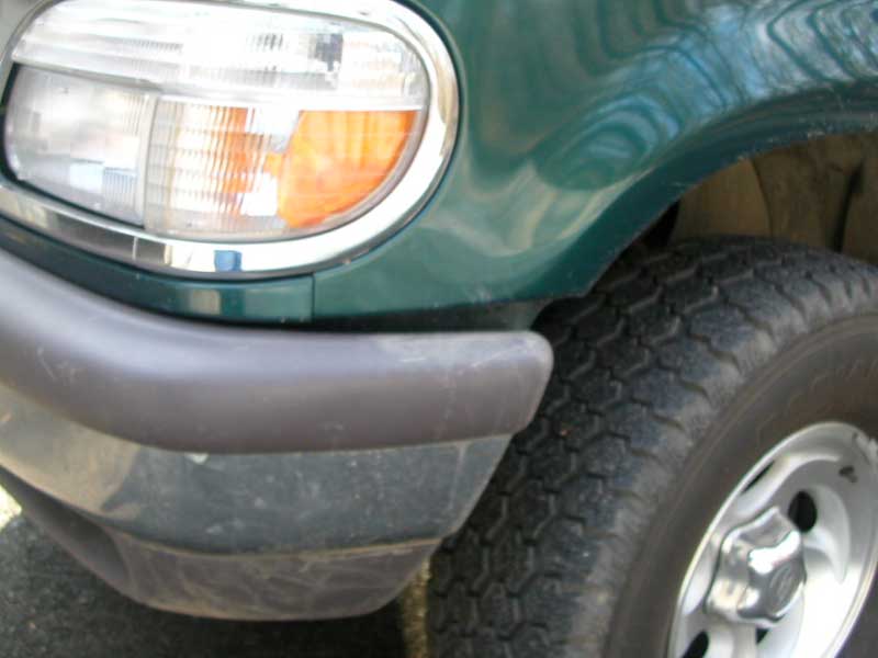

Well I got the front fixed. Basicly I just pulled the bumper and the brackets off and put it all back together again. I straightened out the brackets and then attached them to the frame rails first, and then put the bumper on. I did it the other way the first two times, and it was no good. It took some fooling around with it to get it to go on without a sag, tightening and loosening different bolts, but in the end it came out almost perfect. I'll post some pics tomorrow.
I'm going to take another crack at the rear later this week or next week sometime.
BTW, thank you everyone for your help with this. Hopefully anyone else who has this problem will come accross this thread.

Here's my front bumper after I fixed it. It's almost perfect, and I'm pretty happy with it.
#1.

#2.
