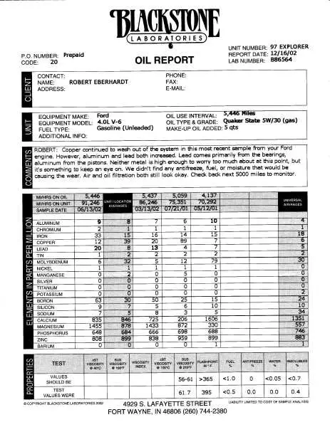

I've been using Blackstone Labs for a couple of years now. I have been very satisfied with their reports. Here is my latest from my Explorer. I usually send in about every 2nd or 3rd sample. I'll be sending in my next sample that I take in the next week or two.

Just read the fine print on the Blackstone Labs fact sheet... they charge you an extra $10 for a TBN test. This is included with the Oil Analysers test.
What's a TBN test? I noticed a check box on my order slips but I've never checked it.
TBN is the Total Base Number; It is a measurement of the oil’s active additive package
