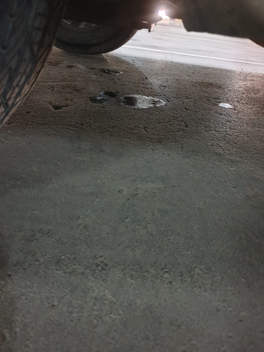

i was having a transmission oil leak from the radiator. I changed the radiator with a secondhand one and it looks clean and i'm not facing any heat issue with the engine, but I'm getting a smoke when I'm trying to accelerate and remove my leg from the accelerator.
After checking i found that the gearbox breather leaks the oil and get the smoke once it touches the hot engine parts. the mechanic said the oil level is ok and it might be an overheating issue.
any ideas how to diagnose the issue, and the best solution?

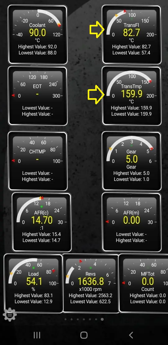

I checked the Transmission fluid temp using "Torque pro" and it was about 80c to 91c after driving more than 30 minutes with outside temp 26c.
so i think there is no overheat in the gearbox. but still getting oil leak from the breather hose when leaving the accelerator after 4000 RPM.

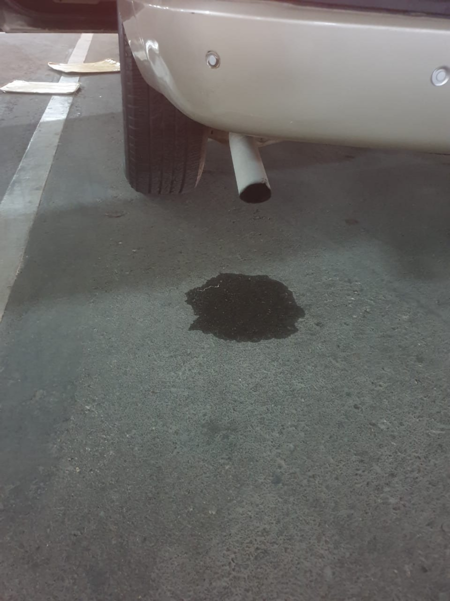

Now there is no smoke because the mechanic changed the breather hose direction to spill the fluid on the ground. but of course this is not a solution.
when I leave the accelerator the oil start to come out from the breather hose, also i noticed there is a water coming from the exhaust when i leave the accelerator

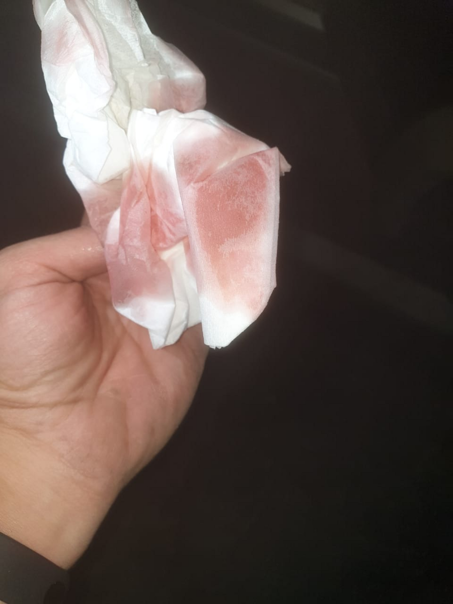

the transmission fluid looks very clean after driving more than 1500 KM

also i tried to monitor the temp using the OBD2 Torque pro, but some sensor didn't read.
however i added the "Transmission Temperature" and it was not reading, but it gives one read 159.9c "320f". it didn't go up or down while driving but it seems very high.
the "Transmission Fluid Temperature" was 82.7c
what is the deference between the "Transmission Temperature" and the "Transmission Fluid Temperature"
