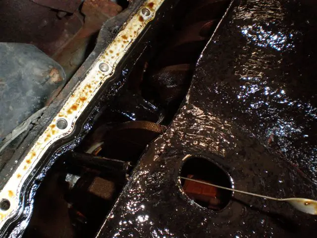

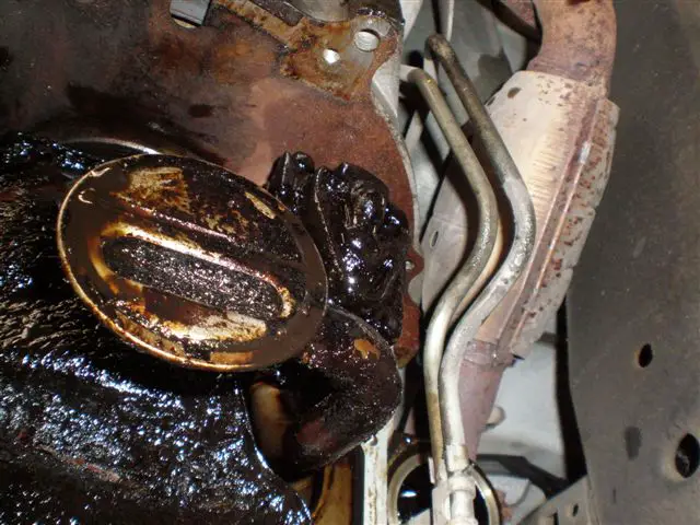

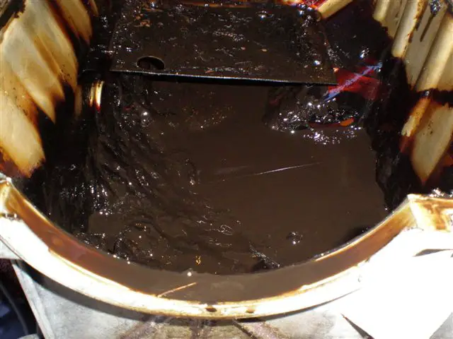

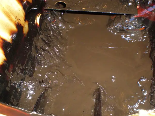

This is what I found when I dropped my oil pan and replaced the oil pump, pump pickup, and driveshaft...The driveshaft was fine but the sludge in the pan was pretty bad...After I replaced the pump I drove this engine for 20k miles and would STILL be driving it but I found 2 of the cylinder walls chewed up so I replaced the engine...

Yuck!... think i need a engine flush after seeing those pics!
Please....what kind of oil are you using and what's your oil change history?
Jeez Ranger thats sick, was that caused by serious neglect of oil changes ?
I bought it that way...
I knew I was in trouble when the oil started coming out of the drain plug in chunks...I believe the original oil filter was still on the engine...BTW I used Mobil 1 after installing the new oil pump and the top end sludge still didn't go away after 20k miles...
There was more sludge in the top end as well...So much so that one of the rockers stuck in the down position and the pushrod fell out of the cup and caused a dead miss...
