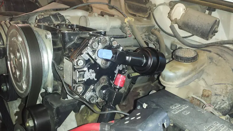

I have had a York mounted on my truck for a while now. It has been a great mod. I am glad I have had it. Here is my write up. If interested I can cut more brackets if people are interested.

I saw your write-up and it's a good one. That pretty much where mine is going, but I am going to use the factory tensioner.
I have a 3" body lift so cutting the hood and power steering Cap (iirc that's what you did, I may be mixed up with another thread)
RockRanger, what angle do you have between the power steering bracket and the York? Trying to double check my work before I start cutting
That is mine. Having a body lift should make it easier. I still use the factory tensioner. The one pulley allows the belt to clear the air intake. The second one is debatable if it is really needed. I added it so I could get a bit more wrap on the power steering pulley. It probably would be fine with out it but it wasn't hard to add it. Mine also is setup so if I ever have problems with my york I can install a non a/c belt without unbolting anything and bypass it.
Now I am working on installing a saginaw pump on my truck. The york is in the way for it. Have to go to the junkyard tomorrow to see what I can round up to make it work.
If you have a body lift I would run as much angle as you can that still clears the hood. I had to notch some of the under bracing in my hood to allow it to clear. My pulley clears my hood by roughly 3/16" You could probably stand it up another 20 degrees over what I did.
I was going to run it level (on its side). I'm looking at about 23 degrees to get the York level. And I'm going to use the extra space to bring the entire compressor further up away from the power steering reservoir to clear the cap and be able to reach the mounting bolts
The more and more I look at your mount the more I like it, in case I get fed up with my mount what do you want for one of yours rockranger?
I will sell you all the cut plates unwelded for $40 shipped. You would have to source all hardware and other parts yourself.
