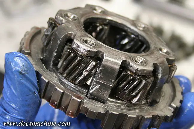

I just yanked the 4R55E out of my '95 Explorer, and got it taken down. I'd found plenty of junk and debris in the pan, so I knew something was up, the only question was how bad it'd be. Turns out to be pretty bad.
While some parts- like that planetary- will definitely need to be replaced, I'm wondering if some of them can be fixed.
