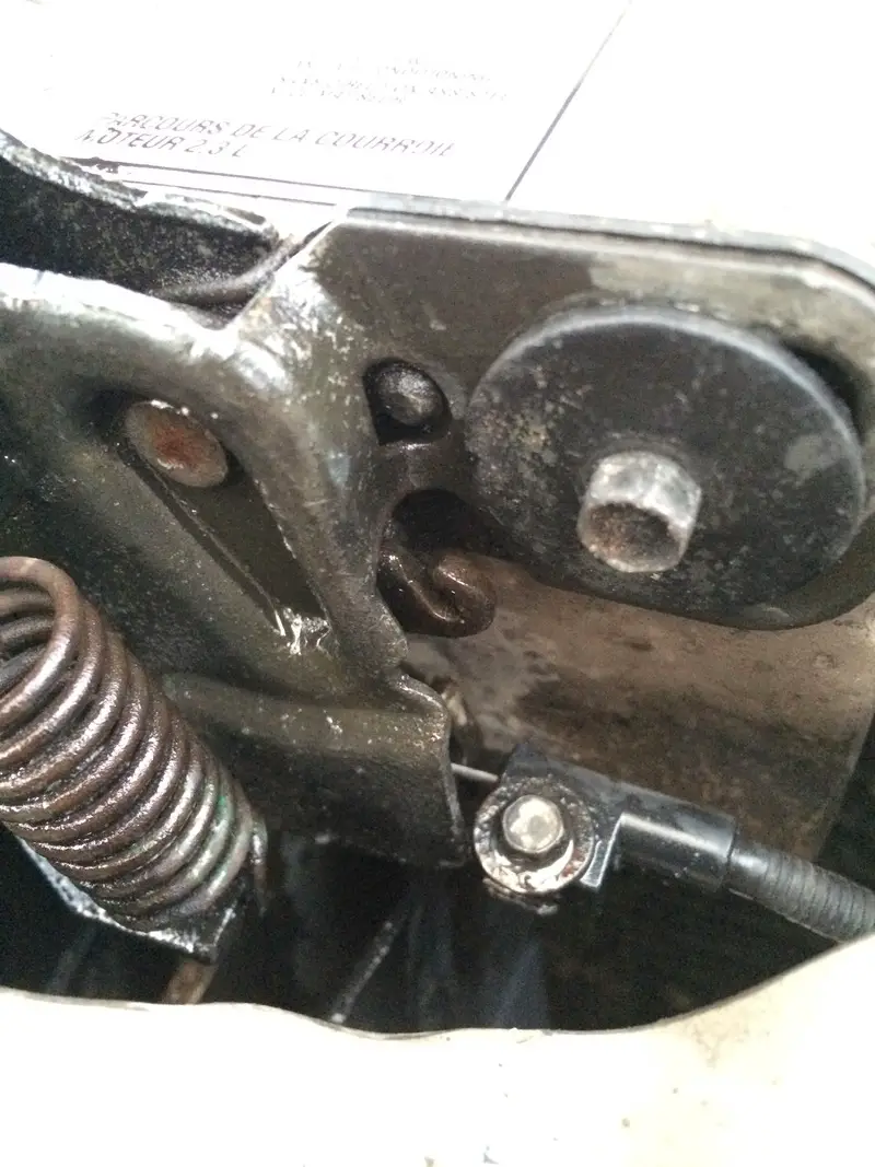

A better example would be to take a photo with hood closed and place an arrow to show where to insert a tiny slim screwdriver.
I tried taking a few pictures with the hood closed but none came out very well.
If you try to stick a screw driver in between the hood & the grill you will have to push down on the grill a bit to get the long skinny flat blade screw driver to work.
What I did aswell was reach inside the grill with the screw driver & pop the latch from below, if you look at the picture you can see the release is about an inch above the cable, if you keep that in mind you'll find it easier, although its hidden pretty well, you have to stand to the right & look between the hood & grill in order to actually see.it.
Hope this helps, Lee

Well I found a you tube video that pointed me in the right direction & I got my hood open.
Heres what my safety release latch looks like (its the hook shaped piece right above the cable) on my 96 XLT Ranger 2WD 2.3L It was not in the same place as the one in the video.
Also my cable was not broken but the outer plastic outer jackett had worn through where it makes a 90* bend behind the battery. So when I pulled on the release handle the cable pulled through the outer jackett & didn't pull the hood release far enough to open the hood.
