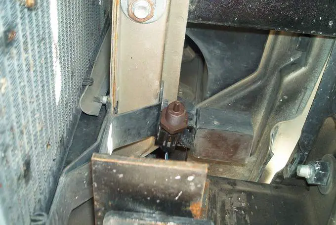

i'm glad i read this. i also have a scrwewed up temp reading.....it's 85 out and my temp says 45...ok:rolleyes: . anyway, i thought it was located in the overhead console. i remember someone saying it looks like a tube of lipstick..the shape that is. is that what i'm looking for? cuz it probably needs to be replaced. thanks.
Well...
here is mine on my 99. The sensor looks like a big, brown, nut with 2 wires coming out.
Ken
thanks for the pic bottomless. i'm glad b/c i thought i was gonna have to rip apart the overhead console. that thing looks like a pretty easy replacement.
earlier sensors look a bit different... but generally if you search around front you'll find it. It's the only thingy that has two wires attached to it. When you replace this dang thing and it's still goofy then your overhead unit might be to blame.
