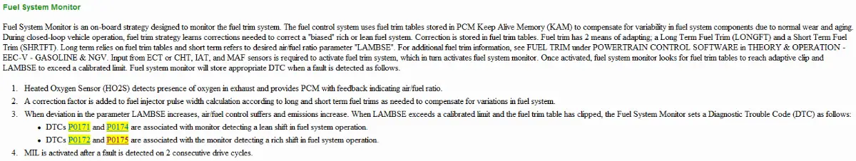

Hello all. I'm trying to figure out what's the deal with this P 0172 code that won't seem to go away on my 02 explorer 4.0. I recently replaced plugs, wires, ignition coil, MAF sensor and air intake. According to the scan tool data from AutoZone it's saying bank 1&2 are too lean but my truck is running and idling just fine though. Not doing too good on gas though. Does anyone have any suggestions on how to troubleshoot this problem? Thanks

I believe that the "too lean" code means that the computer is maxing out the fuel adjustment but it is still running lean. This is usually caused by unmetered air getting into the manifold. This could be caused by a bad/cracked vacuum hose, leak in intake hose, or bad/dirty MAF. Since you have replaced the MAF (of course this doesn't mean it's still not bad) I would start looking at all the hoses connected to the intake for splits or breaks.

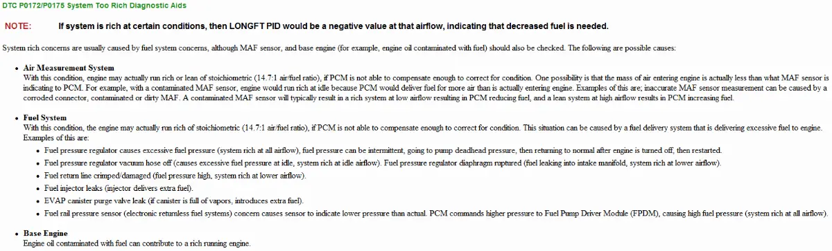

P0172 is too rich NOT too lean !!! Which would explain why it's not good on gas...

Thanks for the info. I finally was able to find the problem. It turned out to be a dirty air filter. After I replaced it, the CEL went off in about 30 min and hasn't came back on since. It's amazing how the simplest of things can get you.

Same issues here. Done plugs and wires. MAF, carbon cleaning. O2 sensors. leaking thermostat. hose check and replace as necessary. STILL throwing code. Due for inspection 60 days ago. HELP.
Uhm, change your air filter?
