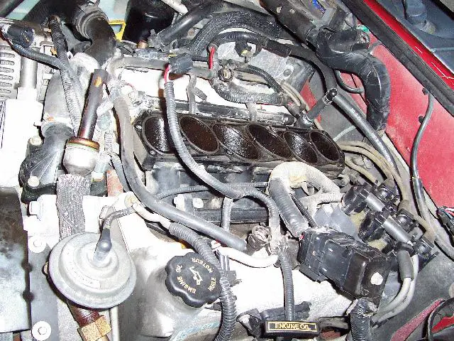

Since only one bank is lean, unless the mixture is just at the limit, it's probably not the MAF sensor or fuel pressure. It's probably either a leaking hose or gasket(s) on the driver side. Most of my leaks were from the gaskets between the heads and the lower intake manifold. Before replacing them I would check the hose from the PCV valve to the upper manifold, the brake booster hose to the upper manifold and the hose on the bottom of the upper manifold about half way back from the front with the plastic insert keeper. You can see it in the photo below between the engine harness main connector and the oil filler cap.
Thanks for the info, I checked the hoses and sprayed starter fluid on them they all seem ok, would a bad PVC cause this error? I might have to change the lower gaskets next to the heads:mad:.
