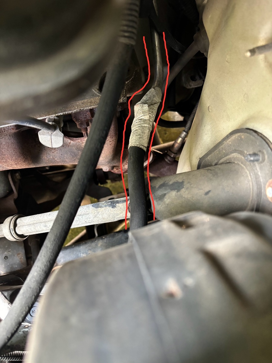

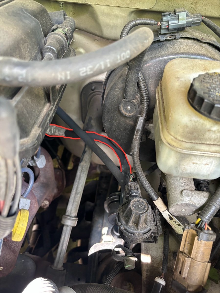

A quick inspection of the hoses finds one coming off the purge valve had rubbed on the steering shaft.
Has anyone replaced this hose before? What did you use?

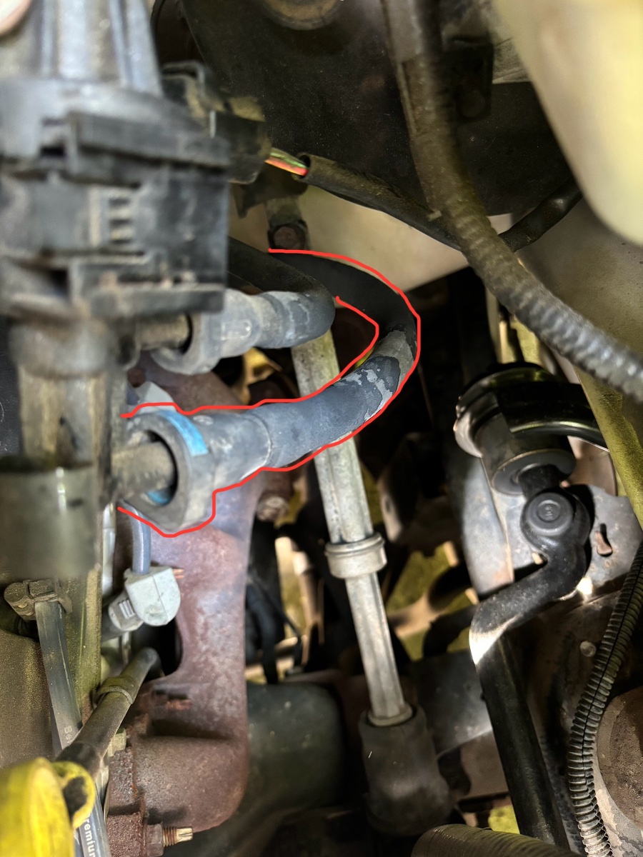

This engine was swapped by a shop from my wrecked Ex into the current one. It looks like they used tape to seal this onto a metal tube from one end. Hose does not look new.
I just purchased 1/2” fuel line to fix. Went ahead and did the other line with 5/16. Just reused the end fittings.
