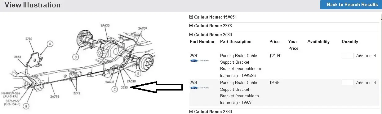

The cable connector/equalizer
or the braket to frame (no number)?
The cable connector seems to come with the OEM brake cable

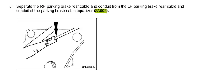

The cable connector/equalizer. I found it called out as 2A602 under 2000 Explorer shop manual.

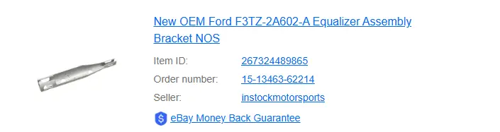

I think this is it:
