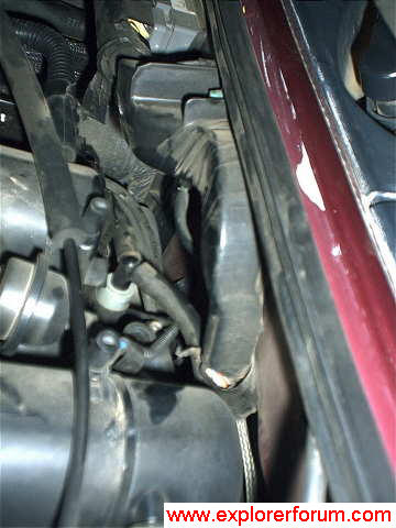

It is located behind the upper intake manifold on the passenger side. Its right behind that black bracket which holds the EVR solenoid. I'll take a picture and post it if you still can't find it. Let me know.
That would be great if you would do that. I see you are a Ford Tech, can I ask you some questions regarding some recent problems I am having with my ride?

So it that the PCV valve, the white piece with the 2 tiny hoses coming off of it?

Yes (actually it is light gray). Be sure and get one with the 'T' already on it. The one I bought at Checker Auto Parts didn't come with it so I spent an hour getting my old one off and put on the new PCV. The plastic 'T' is extremely hard and doesn't flex over the ridge on either PCV. Next time I'd gladly spend twice the $ to get one with the 'T' already on it.

For those of you that have the 4.0L SOHC, as you probably figured out, the PCV is on the top rear of the engine block intake manifold about 2" in front of the firewall almost centered on the engine. There is a "T" adapter that goes into the top of the PCV. Pulling the PCV out of the manifold hose and out of the "T" fitting is easy but getting the new PCV back into the "T" fitting can be slightly more difficult because the rubber has hardened with heat. What I did that made this easy was to follow the two hoses from the "T" fitting and disconnect them from the intake manifold. They come off easily. Once you do that, you can remove the "T" fitting and two pipes as one piece. Take the new PCV valve and press the new PCV into the "T" fitting with an adjustable wrench or even better, a vice. It doesn't take too much pressure, just slightly more than I could muster with my hands. Then return the "T" fitting with two pipes and the newly installed PCV valve and return them from where you removed them, reattach hoses. Popping the lower half of the new PCV valve back into the hose is easy. Total time, 10 minutes. :D Actually finding the PCV valve, 30 minutes :rolleyes:
