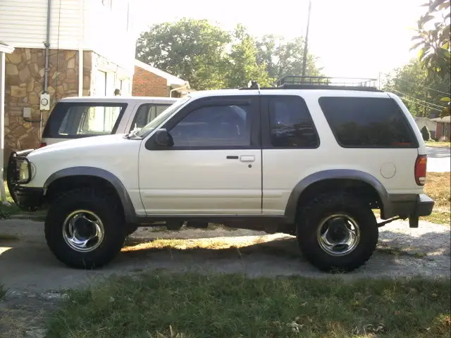

Thanks guys. I guess that will not get me anywhere near were I want to be. I tried to contact the owner of this Explorer here to get the specs on his Sport with no luck. Anybody have any idea what size tire and lift this would be? This looks perfect to me.
Those look like 33's and it looks like a 4-6 inch lift, possibly a 2-3in body lift on it and 3-4 inch lift kit.
I am guessing NO body lift. You would see more frame, if it had a body lift.
I'll say 6" suspension lift rollin' on 33's :dunno:
I think your right, I was comparing the look to the picture above but it has running boards.
Hmmmm I was guessing a 4" lift on 33s. I like it because it does not leave a large fender gap.
That guy doesn't come on here very much anymore, i don't think he even owns the explorer anymore. Anyway, his name on here is "scexplorer," and the truck was on 32s and had 3" spindles, 1.25" torsion twist, and 4" trailmaster leaf springs.
So a 4" lift and 32s should get me there?

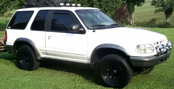

here is a 98 sport w/ just a tt and a 4dr leaf pack/aal on 31/10.50's and some slight trimming of the plastic in the fender
...w/ a 2" body lift w/ same tires
...w/ 285/75r16 (33's)
....w/ homemade 3/8" shackles, i was going to ditch the aal but i am lazy and i dont mind the rake....for now
