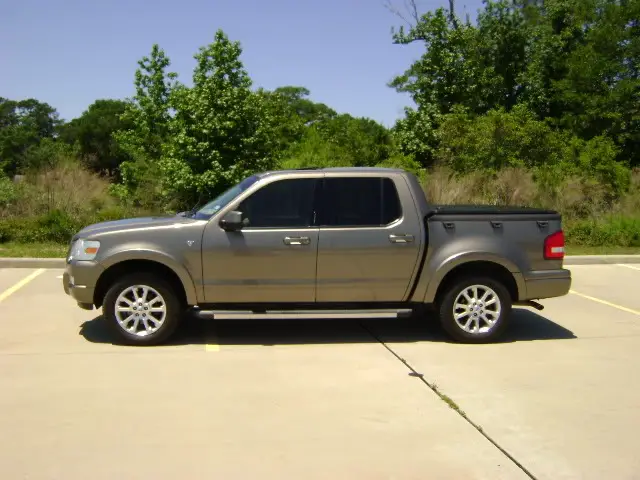

I've got some 265 65 18 Bridgestone Duelers. Just wondering how they'll look on my ST below.
Also any changes in speedodometer readings and / or gas mileage ?
Your speedo will be 5.128% too slow (so says the 1010 tire calc) and your mpg will probably go down as well (probably 1-3mpg).
Also, with 31.5"s there is a fair chance you'll get rubbing somewhere.
Are you thinking of a lift??, I have the 265/70/18 with the truxxx lift, they are 1" taller but the same width as you propose, so I would agree you might have some rubbing as well.
