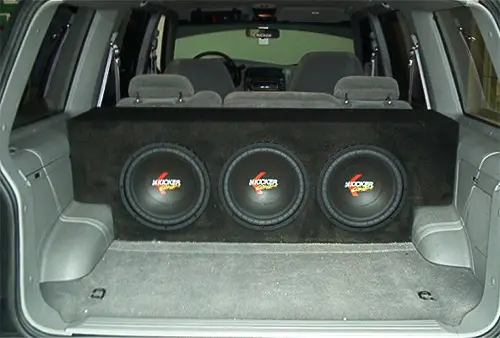

BTW, I know it's dirty!
The box turned out really nice bro!! Where did you mount the amps or where do you plan on mounting them?
looks awesome.. just one thing.. is it just me that sees a line going across the car from quarterpanel to quarterpanel in that last pic?
looks fantastic hartman! great job!
i think thats the sunlight reflecting in from the lift gate being up jssong
The amps are being mounted on the back of the box. The white lines are sunlight reflections. When I get my new amp and get everything cleaned up, I'll post more pics.

I'm really not worried about the amps overheating, they should have plenty of air being mounted on the back of the box. Plus the amp I am getting has fans built in, so I'm not worried. The reason I mounted the amps on the back instead of on the top is simple, I don't want the amps to be in plain view if someone looks into my truck.
