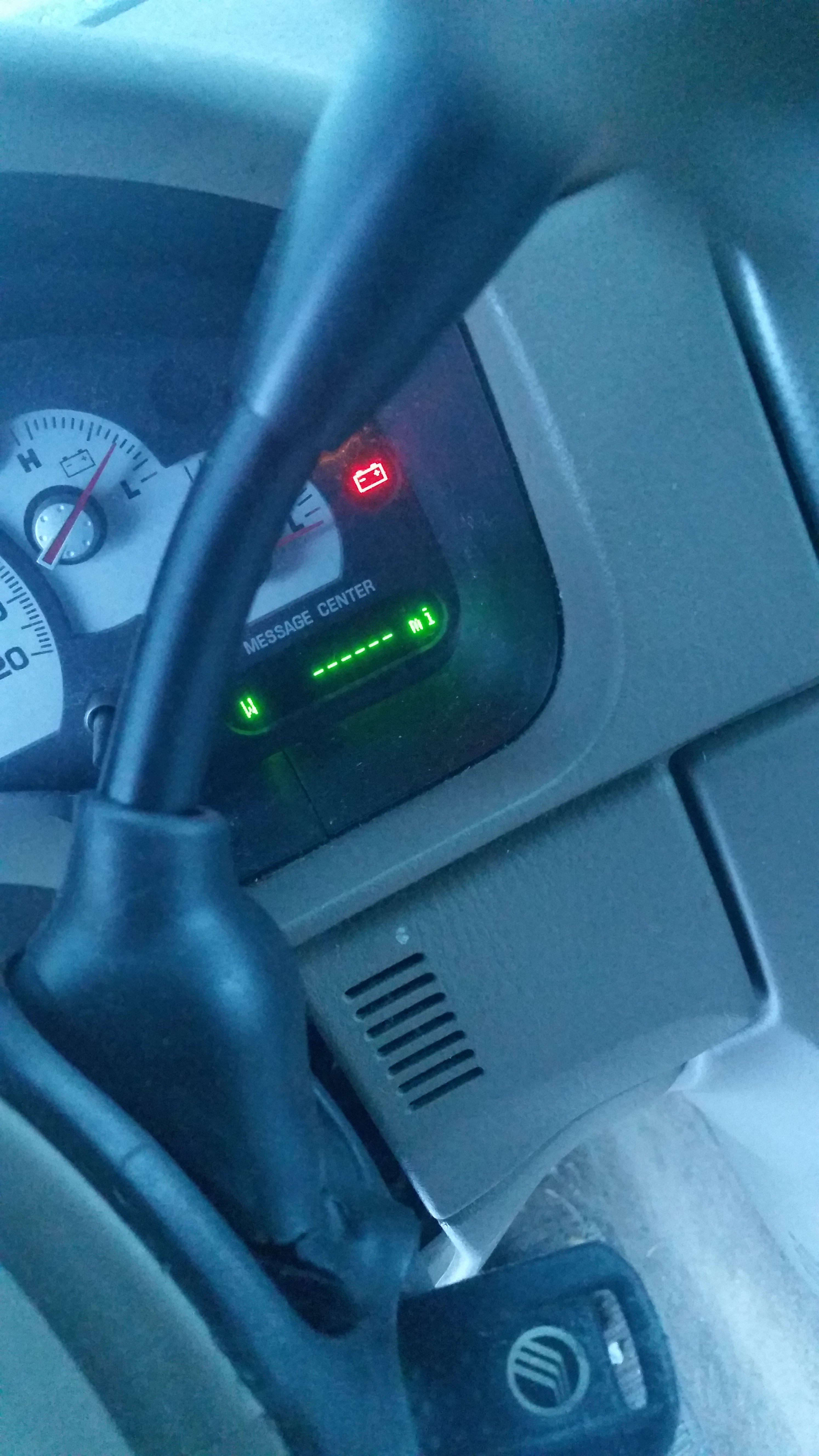

ok, cold weather cheap battery cranked didnt start, replaced battery twice. ground terminal lose replaced it too. tried to start, no crank dash light on. security light blinks fast. was told pats/keys need reprogram. call locksmith he tells me it shows two keys programmed/ clears them tries to program first and says it wont take. tells me get another computer and call him to program keys to it. does this sound right? ive been pulling my hair out, lost job in dec. had cancer last year- removed and clear now. but money is so tight.

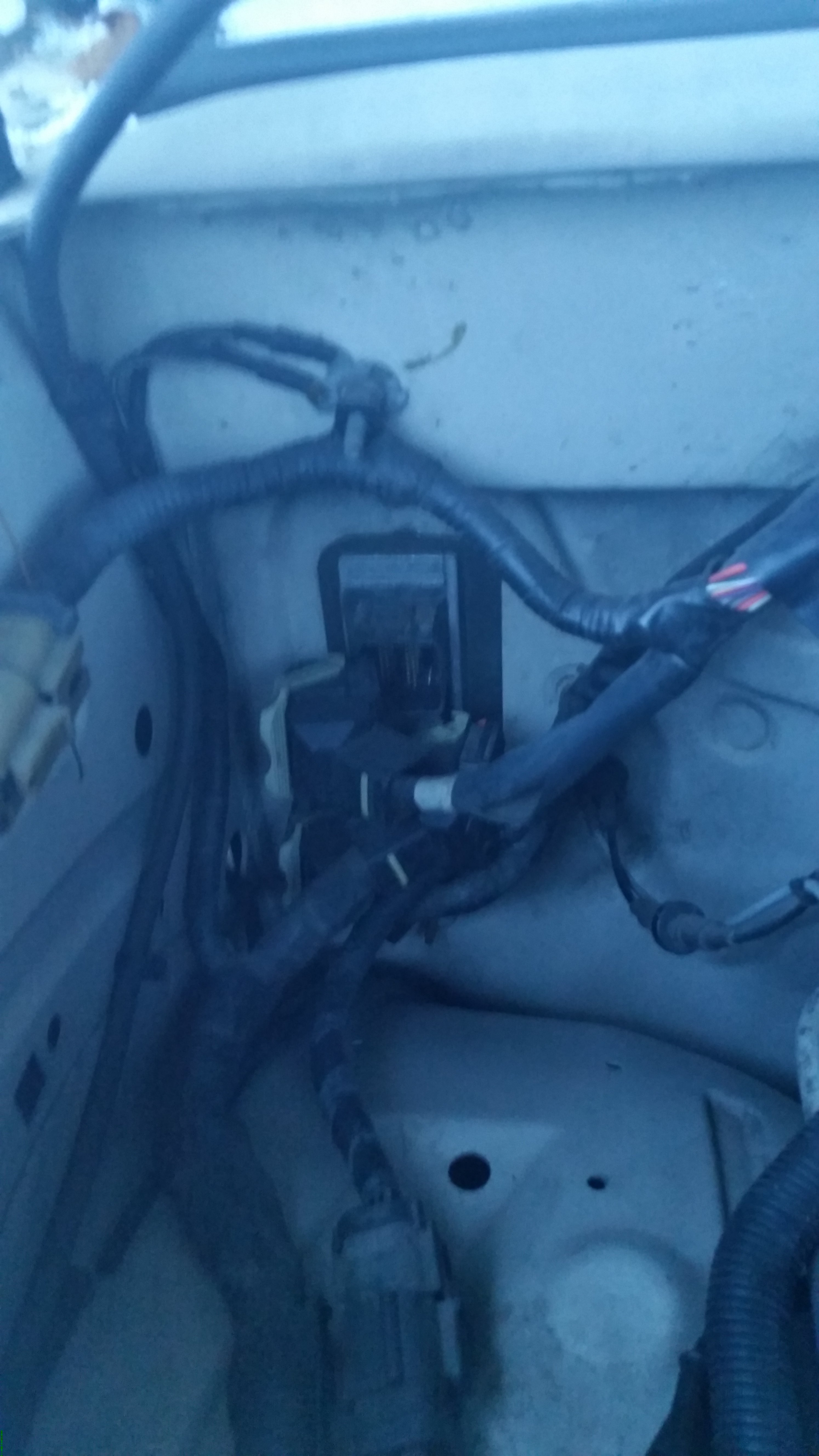

ps i see 2 bolts under hood removed them un hooked 3 plugs what else is needed to remove
Does your odometer show your mileage or ------ dashes?
remove for what? The PCM is not under the hood it's in the passenger side wall just behind the rear seat.

when you when you first put the key in it shows the mileage but after it goes through need oil change low wiper fluid Etc there's just dashes is it the main computer three plug-ins looks like it's on the passenger side firewall pulls in through the passenger compartment but there was two bolts under the hood of holding a bracket also thank you very much for the response
Dashes mean no communication with PCM.
I'd be sure the PCM is getting power, have to check fuses, relay, and diode.
I believe those plugs are just for a firewall pass though.

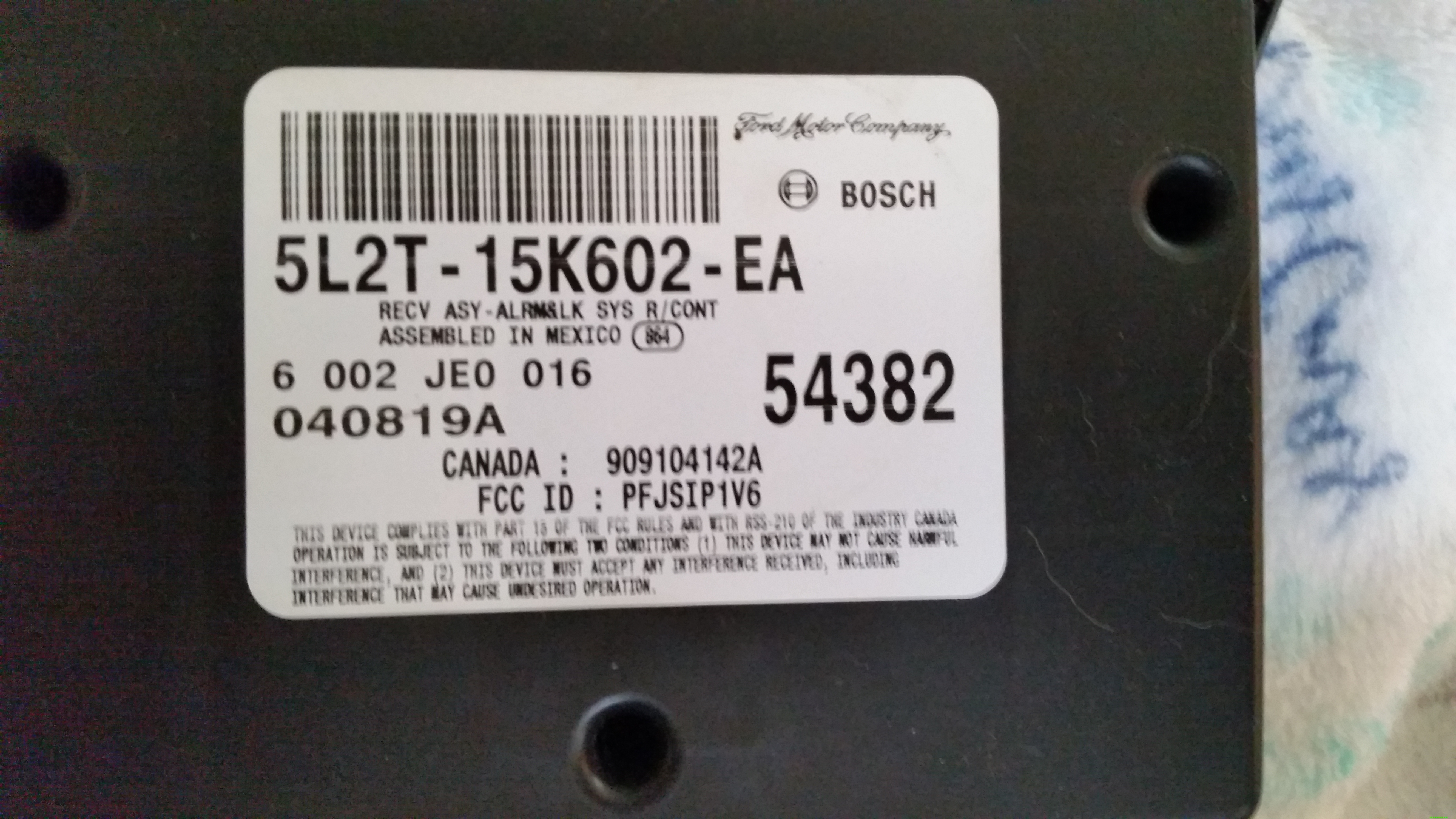

all seemed to check out, except may be diode, did not read continuity either way but has a diode setting, read one way .646 , this is whats behind rear seat in wall, isnt it the pats box?
A diode should read continuity one way but not the other. Sounds like it may be bad... Check the A/C diode and compare the results.

so according to this diagnosis id need a new pcm? on the 2005 mountaineer the pcm is under dash on passenger side? behind rear seat under panel was what i posted the picture off, looks like pats module
