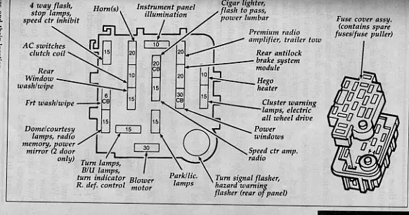

I don't have a manual, I need a first gen owner to look in their manual and tell me the fuse for the signal. All the #'s are on the cover, but I don't know what they do. It is raining cats and dogs, I don't feel like pulling them out 1 by 1 and checking them, I would be soaked. And yes, I replaced the flasher. The hazards still work, signals nothing. Ideally, I would like someone to scan a copy of it and send it to me or post it here

Here ya go!
Wow...thanks. That made it easy for me!

:D Thanks, but if I have ?'s I'll just ask here. Tht's fixed it, hopefully it does not blow again. There's allways guys like Jdraper willing to help

For the future, fold that print out of the image up there, put it in a lil plastic baggy, glue the baggy to your fusebox cover or under the dash. I have a shipping label plackard sticker bag thing that I keep a fuse guide, inline fuse guide, stereo and acc wiring guide. Comes in handy when out in the rough and you need it fast. I stuck the label sticker bag to the firewall out of site, easy cake. Eat my dust Martha Stewart.
Great.....fuse blew again. No signals. I'm going to go out right now and check all the bulbs first to make sure none have a short.

Sounds like a wet light to me :)
Hazards are still working....
