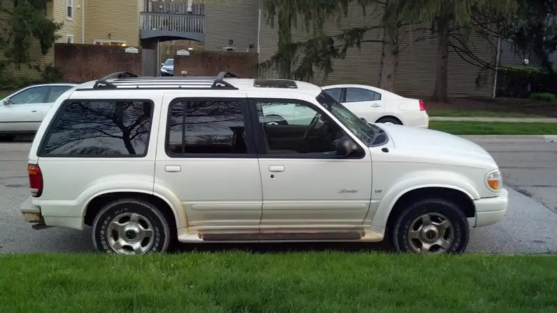

Here is a photo of my Explorer:
So, my Explorer is still up in Ohio, I won't be able to fly up to get it until July. I can't go out and stick my head underneath to check the drivetrain. I purchased this from my mother. She says its AWD. It has been dealer serviced its entire life. They say its AWD. However, I can't see any kind of AWD badging on the body, and the VIN has a discrepancy as per the decoder in the service manual.

'95+ did not use any type of locking hub so there is nothing exposed the the wheels are the same between 4x2 and 4x4. They are the correct wheels for the '99-'01 Limiteds though.
there's no doubt about it. it's AWD. V8's (which your's is) were only available with RWD or AWD. there is no badging that designates AWD.
that's what i don't like about service manuals that cover multiple years. they often don't account for minor (and sometimes not so minor) differences between years.
Oh, and in case you were wondering, you have open diffs with 3.73 gears.
