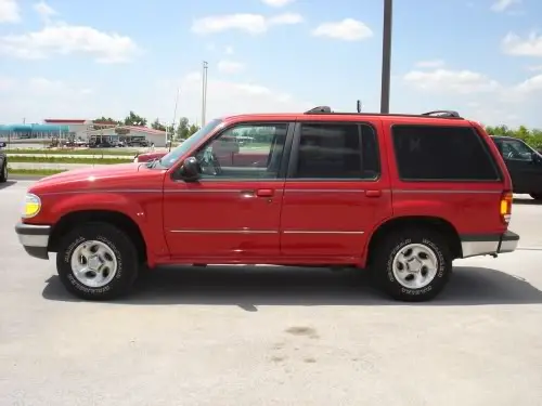

Hello all, I may be buying a 1998 Ford Explorer XLT. Before I buy anything I like to ask questions about the vehicle. What are some areas that I or my mechanic should check over? What's the best preventative maintenance that can be done to keep this Explorer on the road? It does have fairly high miles, but not bad for a 10 year old truck, 119,000. It does have a 4.0L V6 (not SOHC). After a while, I will want to lift it, and put some bigger treads under it, so what is the most cost effective 4-6" lift? Here's the Explorer in question. It's in GREAT physical condition, but I have yet to test drive it.

Blend door. Make sure the heat and A/C work perfectly, and there are no noises as you adjust temperature.
Make sure the thermostat is good and the temp gauge works.
Check the front end/ball joints.
Thourougly test the transmission for any unusual shifting.
When you get it of course change all fluids, etc.
Can't go wrong with the OHV...no major issues.

forget the Chevy. I would get the red X with the OHV. Change the coolant and thermostat(motorcraft), you will get another 100K+ trouble free miles from it if its in good shape now.
Make sure that the trans and the 4x4 work properly.
