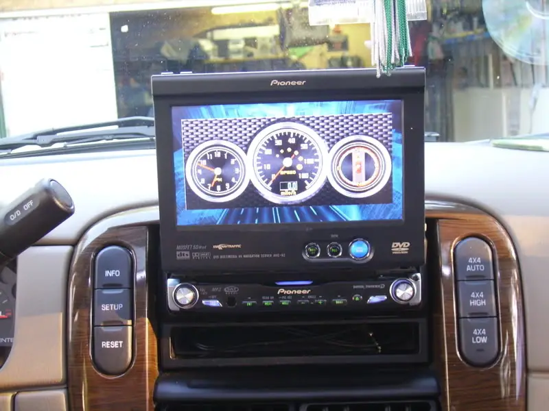

To get around the park brake issue, you just put the wire that would normally go to the parkbrake, straight to earth. Just join it into the black wire, and it will work all the time.
Wrong. That only works on select head units. Others have other devices internally that still will not let it work when the vehicle is in motion unless you have a bypass device.
