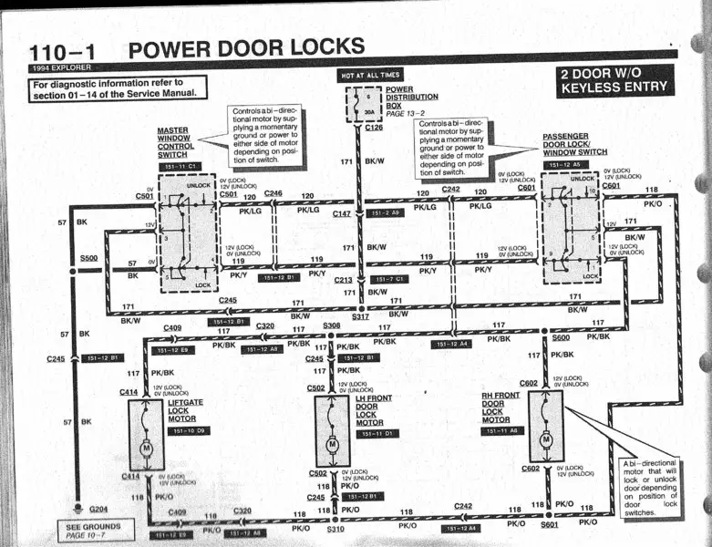

I got my aftermarket alarm, that came with the truck when I got it, removed because it started to act up. So after I got the truck back, I realized that my power locks don’t work. I called the place that removed it and they said that they didn’t touch the door lock switch. I checked the fuse for the circuit and it wasn’t blown, so my guess is that the switch isn’t working and that it needs to be replaced.
