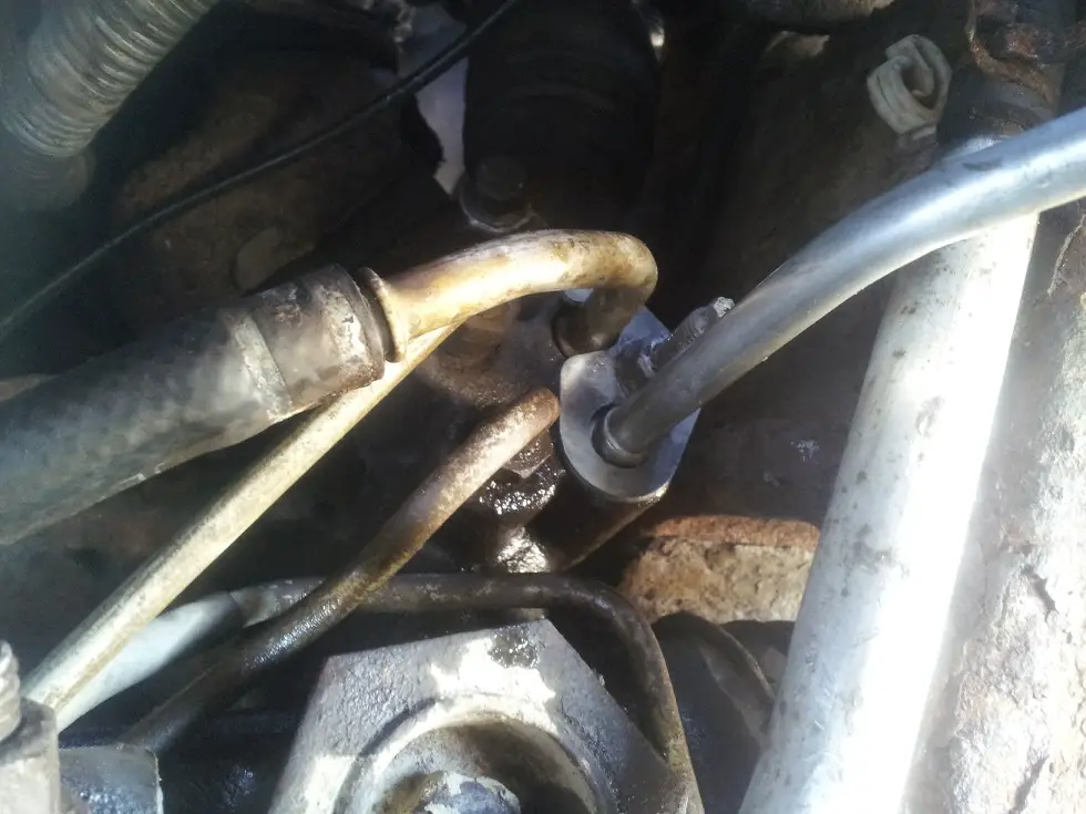

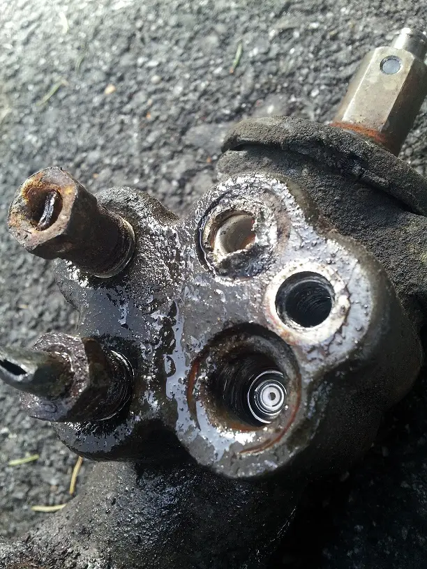

Ok so in trying to fix the other hose, it turns out it was cracked near flush to the rack. ####ing wonderful.
I ended up pulling the whole rack. It's a good thing I did because the rest of the lines were about to give up the ghost as well.
I did, however, manage to save all the fittings. No idea how to make a pressure flare like is on these hoses.
I don't know where in the HELL I'm supposed to find and/or make these lines, let alone get that broken line out of the rack.
SIGH... I'm NOT spending the money for a reman'd rack when mine works perfectly fine...

Yes there are but that's total bullshit. These are nothing more than 5/16" lines with pressure fittings on them (save for the two that are pressed in). They should be available at ANY damn parts store and they're NOT.
I'm NOT buying a reman'd rack for over $200 over ONE ####ING LINE braking!
