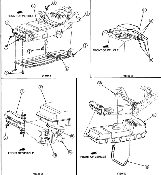

At the front of the tank where the 2 bolts are, there is a bracket of some sort right underneath. It looks as if it was put there to help suspend the tank to make assembly easier?
Well , some good news. I was curious if I could at least break free the 3 bolts to remove the tank, and they did with no problem.
the tank center strap doesn't just help to support the tank. I holds it up. w/out it your tank would be dragging on the ground. PM ne if you'd like some advice on this job. I've done it 3 times and have it pretty much down to a science.
I think you are talking about the mounting points for the tank skid plate? Some (older) models came with one...
Otherwise, the front 'perch' (cantilever bracket) combined with the strap are absolutely essential to support the tank. See below, #1 and #1 1:
