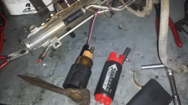

yeah I was planning to go with a bosch high flow pump but where I get all my engine parts recommended me this for my application...

:( HELP..! still have the problem... :mad:
hesitate on quick acceleration if I depress the accelerator easy then its all good, Just remembered I think its worst when its on load..
The reason I say that, I remember going through flood water and it feels like the car is about to stall (lack of power) but soon I'm on the surface then it was all good.
The other time I was on the sand dune and going up hill and I all the sudden did the full throttle and It felt hesitation and loss power (no grunt)...
I am worried that when ever I quickly accelerate full throttle when its on load then the problem comes up...
After I replaced my Fuel Pump it felt the same then I found out my No.! leads is leaking then I replaced that and I thought the problem fixed but I guess not..
Question: what makes the car run rich..? I can smell the exhaust running rich and maybe that's the cause of it 'it floods on load"... :(
