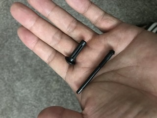

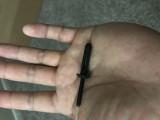

Then I was trying to install a new license plate frame. However, I just don’t understand how does the pin work. I was not able to mount the frame using these pins. The mounting holes on the bumper are bigger than the pin diameter.

It is actually a plastic rivet. You need a special Rivet tool to pull the pin out and squoosh the plastic pin against the back of the bumper.
I would look at alternative fasteners.

After knowing how it works, I was able to install it using two pliers.

Yes, I was able to install them using two pliers. One plier holding the base pin, the other pulling the center pin out, then cut the excess.
