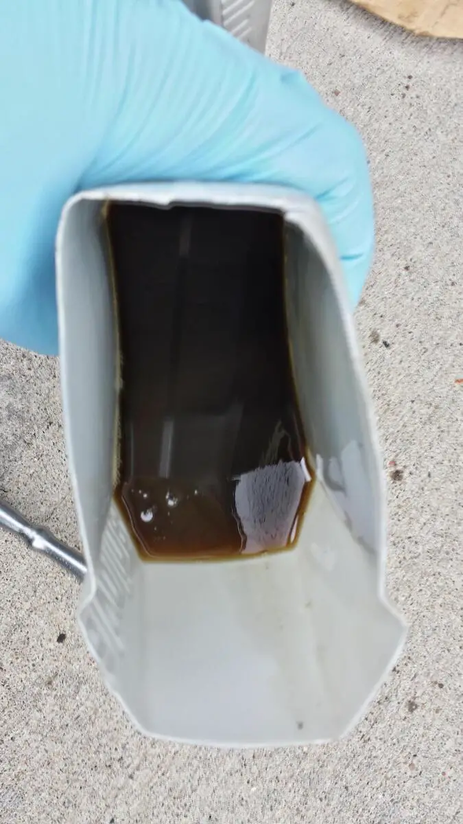

Thanks for the write up, it came in handy, I did a full fluid change this weekend(engine, transmission, PTU, rear diff) My 14 Sport has just over 61k miles on it and the only fluid I've changed is the engine oil. I'd say 75% highway with a bunch of 150 mile trips to/from Minneapolis to Duluth(all freeway). Very little towing.
Since I have a Sport, I have a drain plug on my PTU. I cut an old 1 qt oil bottle to fit up around the drain plug to direct it into another container and keep it off the exhaust(based off of another person's duct tape method).
Pictures below of the fluid and drain plug. Fluid was definitely brown, but still liquid. Plug had some shavings on it. I saved some of the fluid and will send it into Blackstone for analysis. I was able to drain 12oz out of the PTU, so that's what I filled through the vent tube. I used a 2ft section of 5/16" ID fuel hose and a pump to fill. Getting to the vent tube was easy once I figured out to crawl under the driver's side and reach up to the top off the PTU. I thought I read that there's a clamp for the vent hose, but mine didn't have a clamp and just pulled off. I used Amsoil 75w-140 Severe Gear to fill and still have enough left of the qt. that I bought to do another change.
I also changed the rear diff. Similar story, brown, but didn't look terrible. I got just about 1qt out of that. I filled it back up until it started to dribble out and that was right around the 1qt mark as well. Amsoil 75w-90 Severe Gear for that(no pictures).
Last, I did a drain and fill with the transmission. I got about 4.25 quart out and when I refilled with the same amount, it didn't even register on the dipstick. I drained it while it was hot(city street driving), so I was thinking it would be warm enough to check right away. Anyway, I took it for a few mile drive(again, city streets) and came back and checked it again, still not registering(yes, checked while idling in park). It took about another 1/2 qt. to get it to the upper side of the dipstick acceptable level. Similar story for the color, brown, but not terrible. Since it's so easy to change the transmission, I might do another one during my next oil change. I used the Motorcraft stuff for the tranny.
