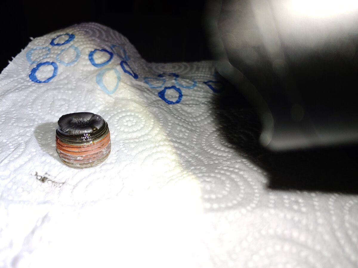

heres the drain plug accessed at the side of the ptu.
its doing its job thats alot of metal build up.

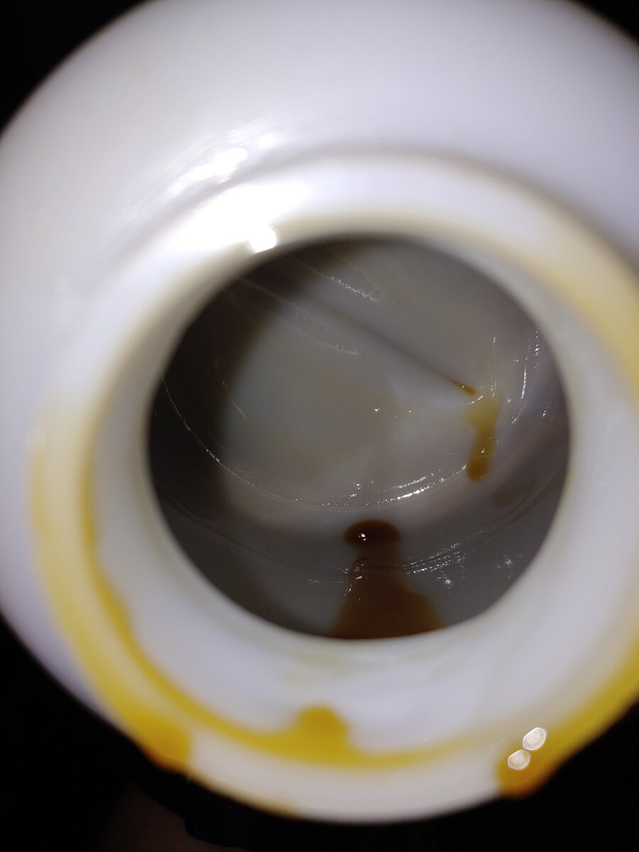

this is the vacuum bleeder i used to pull out the fluid.

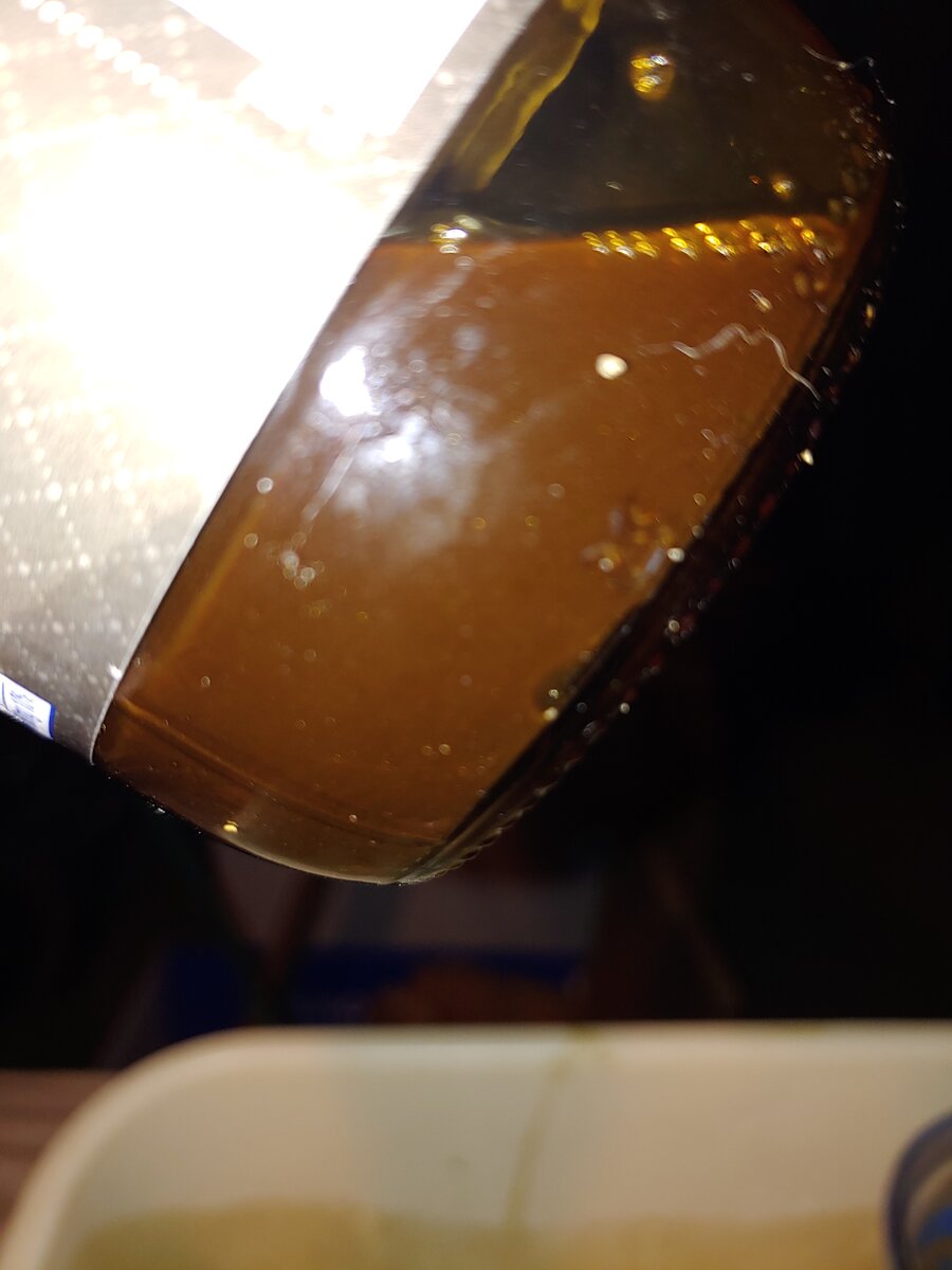

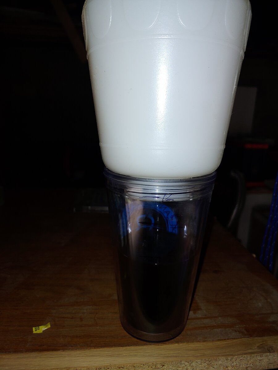

i was only able to pull 7oz of fluid. it takes around 16 so that means i probably have a thick grease at the bottom from the heat of the exhaust. plan is to add 7oz back in and redo procedure after a bunch of miles. hopefully it thins out the current thick grease
oil is dark to be expected, but no metal flakes and didnt smell burnt.
so at 60k i have to assume that half of the fluid has turned to a thick grease.Lesson here 60k is too long if buying any fords with the ptu they should have fluid changed asap.
