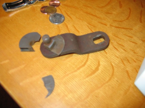

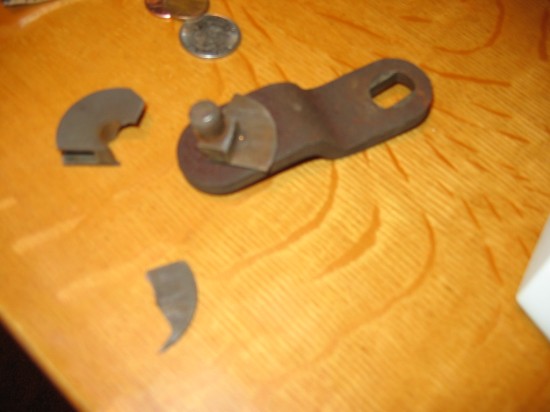

I was on AIM with Doug. He said to use a torch to bend it. So I went to my neighbors and used his oxy/acytelene torch. Works good now, except I need a new bushing.
Know where I can buy a bushing at? Broke this ****ty plastic piece of ****.

Ok, for anyone that cares the part# for that piece of **** bushing is: 3L5Z*7335*AA
Cost was 6$ from Ford. Once I get this, I can hook my linkage back up to the truck. Now I need a boot(s).

Glad i could help, hopefully everything works out for you.. damn 6 bucks? my stealership only charged me 4 :p
Well, it was actually $6.70 I had a gasket(trans to extension housing) that needed to go back though, so I paid 1.75 lol
