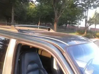

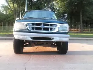

Ok, so a few months back, I bought a wrecked '95 Eddie to replace my previous '94 Sport. I bought it strictly as a toy, and I got it at a great price. After I bought it, I through it on the back burner for a while until I had time to mess with it. I recently discovered that the truck was supposedly driven into a ditch pretty hard on the left side... So hard, in fact, the frame rail bent up and caused the roof of the truck to bend in just enough to make the doors not line up right.
So this is my question:
Is the bent frame something that I really need to address and correct? I'm wanting to build the truck into a rock crawler, so I'm not really worried about cosmetics. I am worried about functionality. Any help would be super. Here are some pictures for your viewing pleasure.
Does it drive OK?
does it only sit lower in the front?
if it sits lower in the rear left as well then it's not a bent frame.. i dont' see how the fram could be bent and still have the doors/fenders and stuff line up at all like they do. (ive had bent frames and they didn't line up at all)
maybe it just needs new springs?

She's bent, look at the roof shot, that passenger A piller is pushed up a couple inches
It's definitely bent. It's the passenger side front. The doors don't line up.
It pulls a little while driving, but overall, it drives fine.
