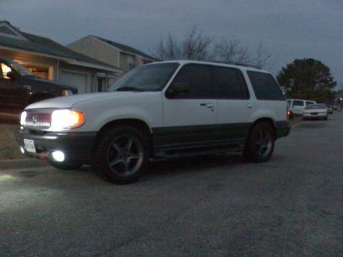

Here is mine. The headers make a huge difference. They are my fav mod along with 4.10 gears on stock tires :cool:

My FMS headers came with a bung on them, they were ones that were later released. I deleted the EGR to be honest, I just capped it. Oh MPG..... its about 15 on the hwy/ 12 city if that. I am hard on it though. By stock tires I mean stock height. Stock diameter is 28.8" and my tires on my cobra r's measure 29". I changed gears for towing and the speed factor.
