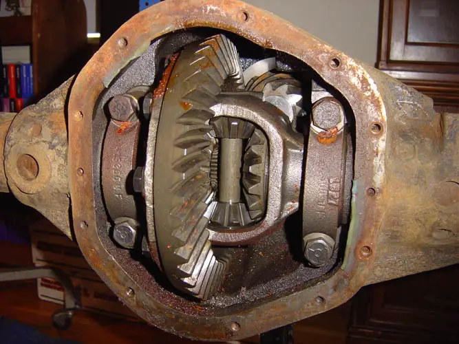

Is this an open carrier? I'm pretty sure it is but I want to know for sure. Still new to the axle building process and trying to learn as much as I can.

Yup, its open. Remember, there is a carrier break on D44's...... if you're going 4:88's and its got 3:somethings in it now you will need a new carrier.
It's got 4.10's in it right now. But I won't need to reuse this carrier if I'm going with a selectable locker will I? Doesn't the locker assembly replace the whole carrier?
Yes. :)
