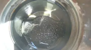

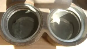

Channel locks work. Protect the piston face, especially if they are phenolic, and make sure it goes in straight when compressing. Better yet, open the bleeder and compress by hand. Flush should be done every two years anyway. One qt. of Valvoline DOT 3/4 should be less than $10. First pic shows what contaminants remain AFTER flushing. That junk is what's getting pushed back into the ABS system and master cylinder when the bleeders aren't opened first.

Topping off is fine, but bleeding is still required any time the screws are opened. Explorer calipers seem to be very touchy, I had a heat and sticking problem on my drivers rear after changing pads. Replaced bore inner seal, dust boot, hose, lubed hardware, etc. Same problem. Ended up replacing both rears with NAPA Eclipse semi loaded calipers for less than $50 each. I would do a flush while you're there, otherwise push in the pistons without opening the screws and do a complete brake flush ASAP.
