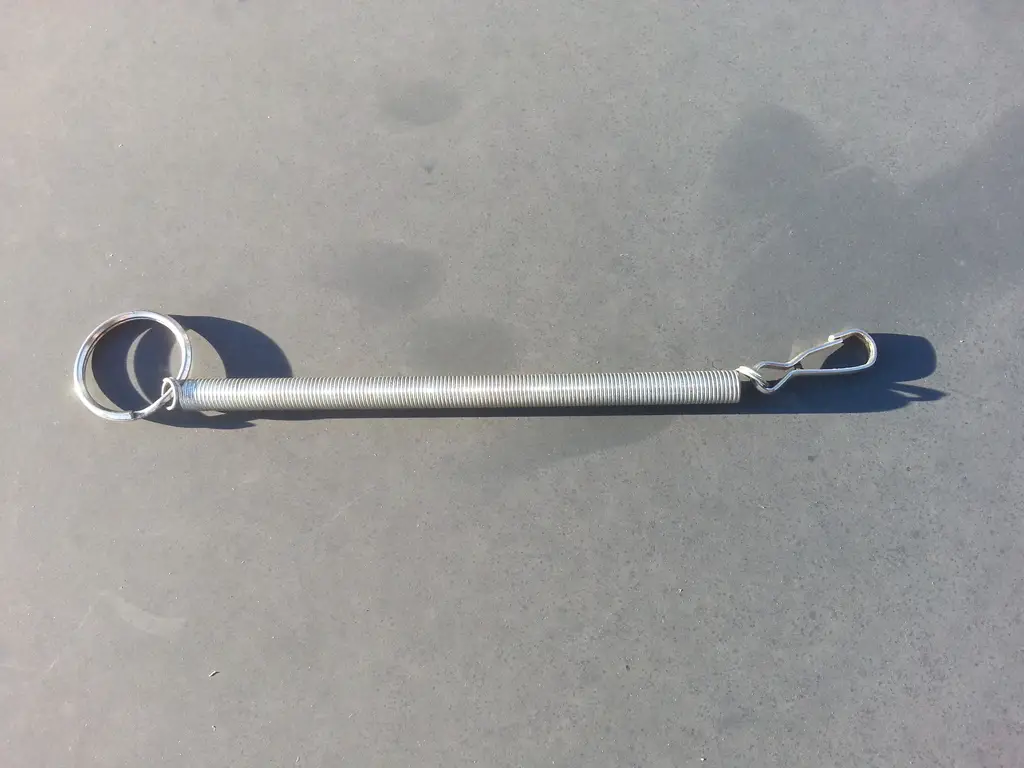

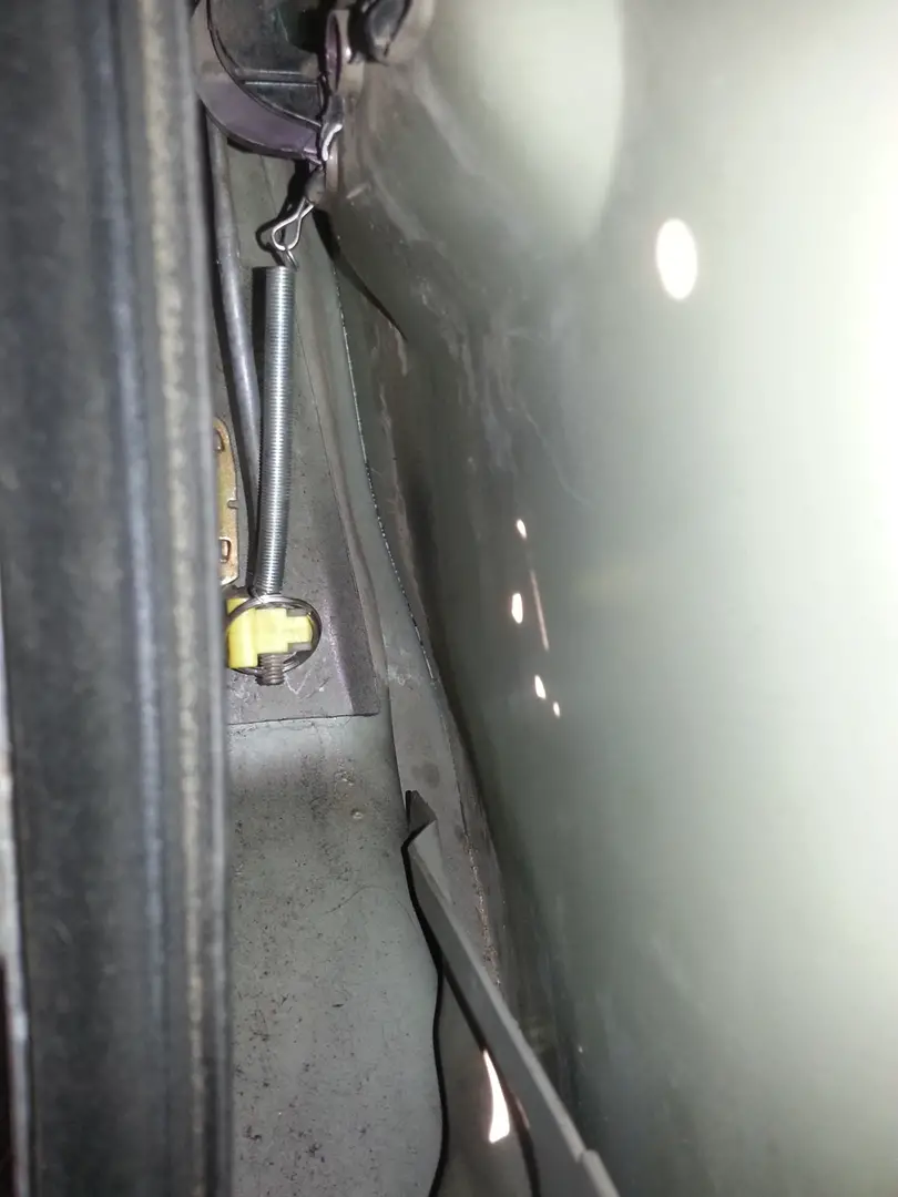

Heres the fix I used on the rear Drivers side door:
I can confirm the spring trick does work on the rear doors.
You need this type of spring (Worked best in my case)
I had to cut this one to size. I used a little over half of this spring.
I added the clip on one end as pictured to clip onto the hole for the latch clearing (latch hinge still clears) and I used a keyring on the other end to loop around the rod and clip.
Here is the finished product:
