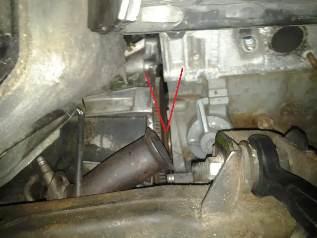

Is it possible after bolting everything down, it will pull the motor/flexplate/flywheel together to mate properly? And the shaft I am refering to should not be protruding at all? I attached an image showing the area I'm talking about. shaft is inside motor, so not visible. Thanks! -DW

I don't believe the TQ is in the tranny far enough...

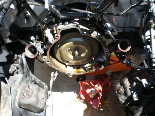

This is a picture when I pulled my old engine and before I prepped the truck for the new engine I built... You can see how far inside the bellhousing the TQ is sitting and I believe I pushed it in a bit more before I installed the engine...
If the TQ is not below the surface of the bellhousing by quite a bit it is still not far enough into the front pump... DO NOT TRY TO FORCE IT TOGETHER... PLEASE...I did not use a ruler to measure how far the pilot shaft was recessed but it was definitely recessed INSIDE the bellhousing...
When the TQ is far enough back the engine/flexplate/bellhousing will all but fall into place... Then you reach inside the starter hole and pull/wiggle the TQ forward into position to get the 4 studs to slide into the flexplate holes... Then you bolt the TQ studs to the flexplate with the nuts...

No forcing yet :-) So if you ran a straightedge across the center shaft in your pic, the shaft would no protrude? Meaning shaft is completely inside bell-housing? If that's the case, that's my problem. Thanks! DW

Yes the pilot shaft of the TQ would be a good 1/2-3/4 inch inside the bellhousing... Oh see that red stud on the TQ? I marked it that way to reinstall the TQ in the same hole as the flexplate... It is a maintaining balance thing... I didn't have anyone recommend that but I do that as a habit when I seperate engines and transmissions...
Let us know if the TQ will not go back into the tranny far enough... Takes some effort and both hands usually...
