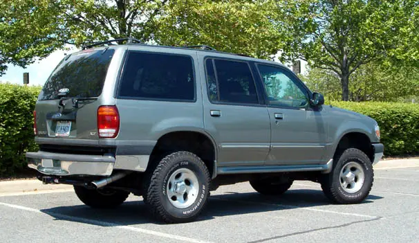

Lifted!
10 hours and a couple complications later!

Looks good Dave.. Now you just need some 32s or 33s.

Thanks Blee! Yeah, 33's with Rock Crawler Street Locks are in the future. After the wedding though... ;) I also need to get some bumper brackets for the rear. Know of anyone who might be able to make me a set?

man thats nice.. its almost like staring into the future..
cant wait to see mine with 32"s
dmasini - looks good! The back bumper is easier than the front one, once you have the right angles to cut off the top inch of the frameunder the bumper. Least that's what i had to do... I've got pics here somewhere..will find and post..
