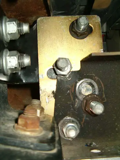

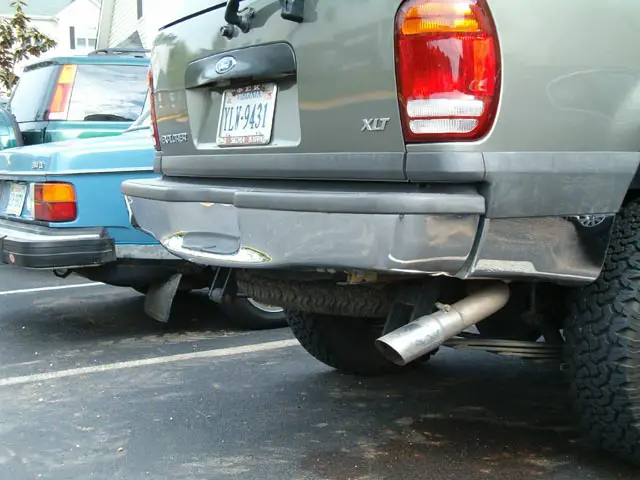

Raised the back bumper finally. And you guys were right, it wasn't half as hard as I was expecting it to be. Here is a decent pic of the bumper raised. In this picture it doesn't look straight but it is....
I also put a picture of the bracket on here as well. Hopefully it might help some people. I was actually able to get 4 bolts into the bracket instead of just the three that I've been reading about. Thanks again for everyones help!

SplashMan said:
Great job, best I've seen it done actually. :thumbsup: For the tailpipe, just cut it back right befor the bend and reattach your tip, should look fine and be far enough from the rocker that it don't melt or warp from the heat.
Honestly I never really liked the tip. It was pretty hidden before the lift. :p I never noticed how much the tailpipe sticks out until you guys pointed it out. Next time I have it in the garage I'll take care of it. Thanks for all the compliments guys! I really appreciate it considering I'm pretty much a novice at all this.
