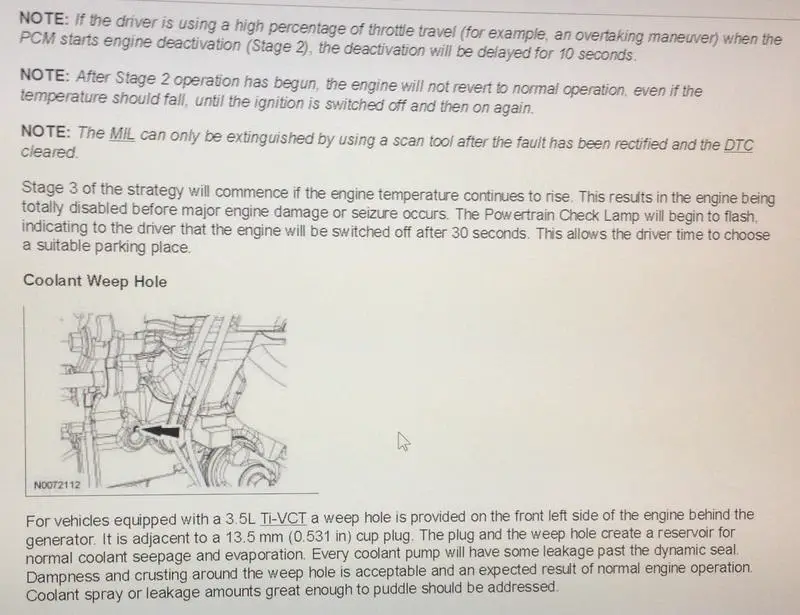

I have a few questions. One question I have concerns the water pump and I had my concerns somewhat put to rest on another post but I am curious, where is the weep hole/vent hole for the water pump located? I would hope it is external so you know if it starts to leak.

I do not believe the design has any external weep hole - but as it over pressures or worse seeps through the bearings - it runs internal to the block and I think is towards a return cavity. IE I should never leak coolant from the engine without a gasket failure. I don't know for certain, I've not seen one leak out.

Thanks everyone for commenting on this. We did purchase the extended warranty along with the ford free maintainence program. I will still be doing maintainence more frequently than factory recommendation, especially the engine oil, trams service and especially coolant. Over my 35 years as a tech I think cooling systems are the most neglected systems on cars. I guess I'm just old school but a100,000 miles on a trans service or cooling system service is just to long. I sure ford will follow their recommended intervals and only provide the free service under their interval schedule. That's ok I'll get half of them for free at least. I did read on another post that someone said there is a weep hole for the water pump behind the alternator.

A couple of pics of the water pump and weep hole location. Enjoy. :D :salute:

Thanks that was exactly what I was looking for. Good to know its there.
