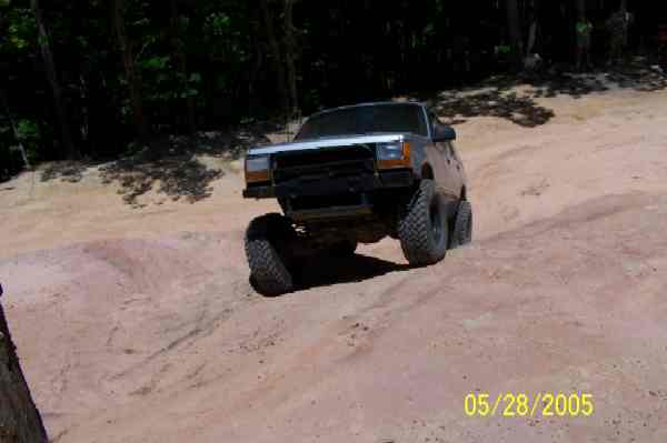

What you will soon find out is that the factory shock setup acts like a limit strap to hold your suspension from full travel. Your stock shocks will work fine as long as the front anti-sway bar is still hooked up and you are not actually trying to use the truck off-road except for some dirt trail running. For anything else, you will soon limit your capabilities and need longer shocks -- longer even than the shocks that come with most lift kits.
One mod I always make now is to cut off the front shock towers and replace them with something that allows for a proper length front shock. The F250 shock mount modification that has been discussed numerous times on this board works well.
Here's a pic of my front end working...
